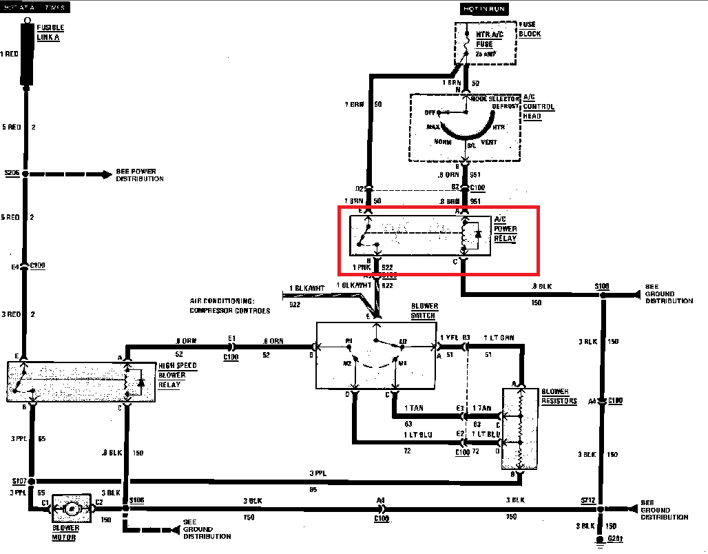

Thanks for posting the schematic. ( gave you a +)
Pyrostatic
I do not remember a relay called "AC power relay"

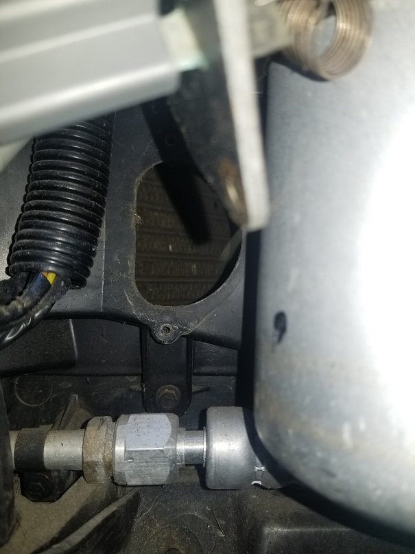

Look at the picture that IMSA GT posted.
The relay with the yellow arrow going to it.
Does it have brown, brown, pink, black wires going to it?

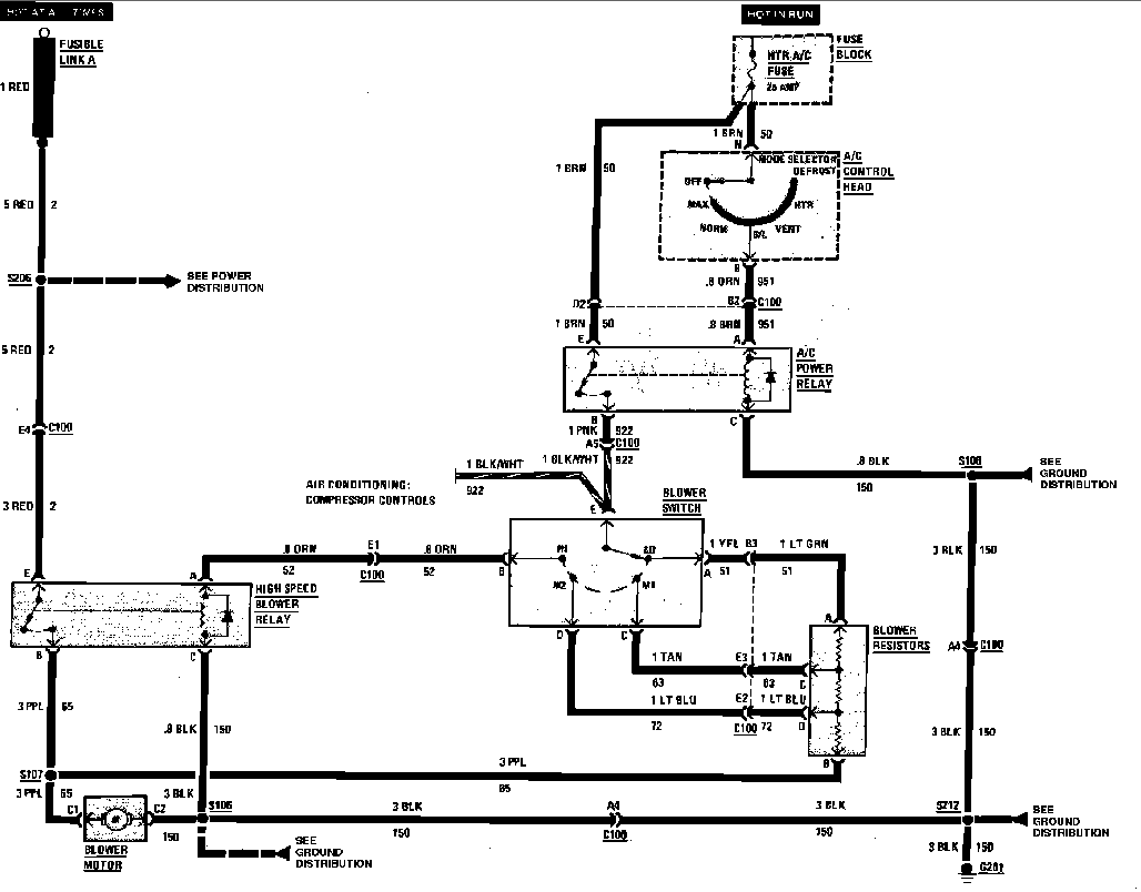

theogre SEP 29, 10:03 AM
Full drawing showing cutoff right side...
Power Relay is why Blower Only shut off when Control Head is Off along w/ rest of AC.
May need this too for V6 but skipping engine blower because 88 deleted that.
CLICK FOR FULL SIZE
Likely motor have problem even if can run @ high speed.
Can be motor dying to wires and other parts cause low volts.
Motor w/ bad wiring gets low volts and can pop a fuse when you're lucky. See my Cave, Electric Motors
Motor dying can cause high draw @ low speeds and pop a fuse.
Blower at High speed bypass low speed parts and doesn't have a fuse. Dying motor still draws more power and a problem to rest of car.
If car has Low Volts problems then likely other things have problems too. Example: Rad Fan is basically heater blower on High and doesn't have a fuse for the motor. Do Not Trust Volt meter in the dash.
Get a "small" meter w/ DC Amp Clamp.
If you have whatever blowing fuses or Battery Leaches this will find them w/o cutting wires etc.
Example: https://www.amazon.com/Uni-...itance/dp/B00O1Q2HOQ
If not a relay, motor, or other things w/ plugs... Might what a fuse blinker. aka a "short tester automotive"
example: https://www.amazon.com/Tool...Tester/dp/B000RFLR0U
Red part is blinker can that load up a short w/o burning fuses etc. Can get all electronic ones too.
take a blow fuse and cut plastic some to use it to connect the blinker parallel to the dead fuse
(Jurassic Park)

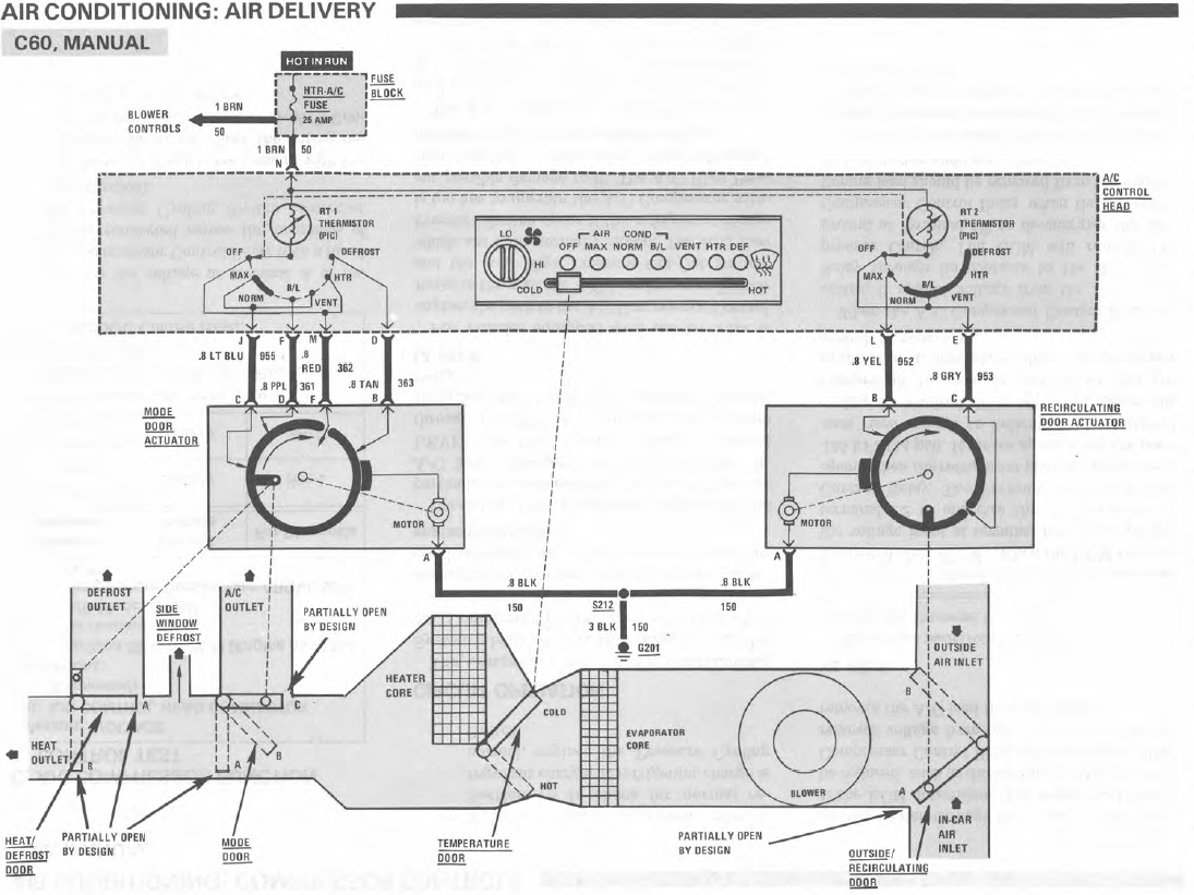

Rexgirl SEP 29, 03:41 PM
It appears this fuse also feeds the air distribution motors, and one motor may be shorted to ground.

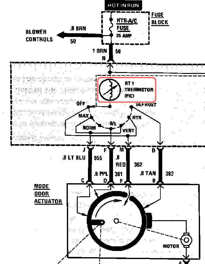

theogre SEP 29, 06:48 PM
CLICK FOR FULL SIZE
Maybe but unlikely...

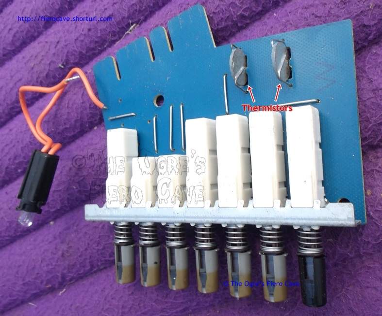

RT1 (Shown below in Red Box.) and RT2 are PTC Thermistors that limit power to the Mode Motors. In very short... They can, likely will, cook off if there's a short downstream of them and prevent blowing a fuse repeatedly.
On the Control Head, they are small disk shape parts similar to ceramic capacitors but different color.
Also those motors and built in switches are very small and fry easy too. If RT1 or RT2 fails shorted, the motor block will die and very fast because can't handle full power.

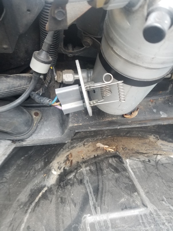

In this picture:
Is the relay I circled the one that is located in the back hatch beside the fuel pressure relay? Or are they two different relays?
The reason I ask is, I had an exhaust leak in the Y of the exhaust. It ended up melting a bunch of wires, especially the ones going to the "A/C Compressor Control Relay" and the "Fuel Pump Relay". I couldn't get the fuel pump relay to work right with the stock wiring after that, and ended up running a power line from the junction block to the fuel pressure relay with an inline fuse. I never hooked that A/C relay beside it back up as the A/C didn't work anyways. I didn't realize it could be important for running the heat, defrost, blower etc. (The heater and defrost did work for a while without the "A/C Compressor Control Relay" being hooked up.)
So... ya, is that relay circled in the picture the one beside the fuel pressure relay?
If so, is there an easier way to fix my problem without completely restoring the A/C relay?
Thank-you.
theogre SEP 30, 07:15 PM
Both relays above are in the front...
Notice some connection go thru C100 below next to Brake Booster.
Power Relay runs most of the system via pnk then blk/wht wires.
If wires fried in back... then yes, likely still have problems there blowing fuses.
