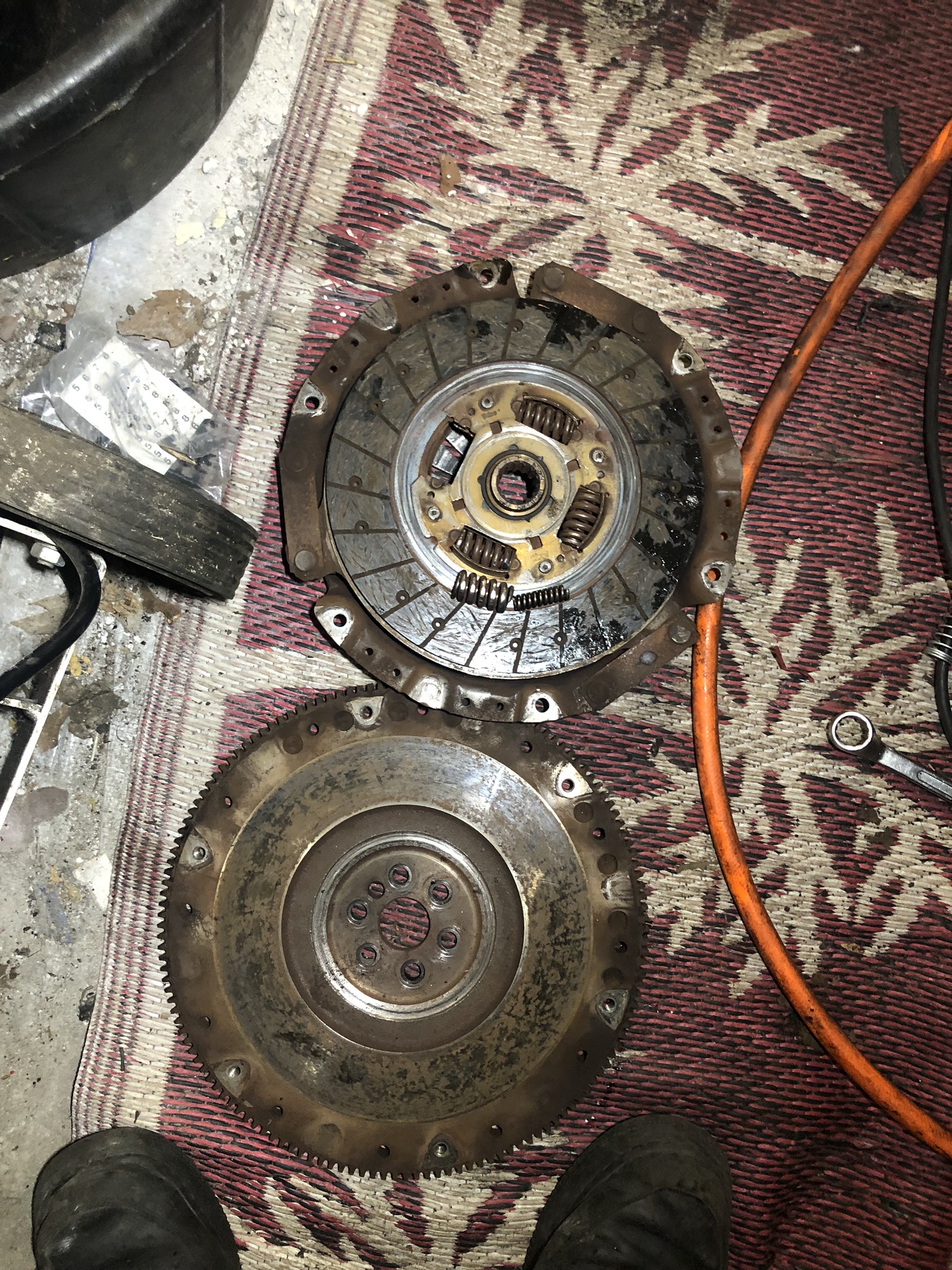

Sound to me like you have this problem going on 🧐 this happened on my 86 gt 2.8 4 speed when I bought from the previous owner he thought it was the slave cylinder or master well changed both out and come to find out I still couldn’t go into gear but had nice pressure at the pedal and that 1-1/2 of the slave rod movement. This was when I was like the clutch is gone let’s drop the cradle and see what happened soon as I had the trans separated from the motor the pressure plate was visible. Removed that and boom this spring fell on the ground 🤷♂️. That’s when it was time to install new clutch and get the flywheel resurfaced put all back together fiero 2.8 was driving and good to go
