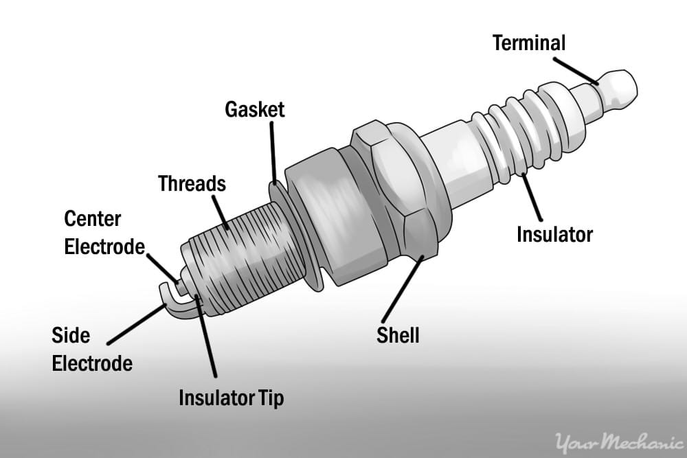

what I thought - what I hoped - was that the hex part of the assembly was spinning separate from the threaded part of the assembly, but the gist I'm getting is that it's all one piece, is that accurate? I know on some spark plugs they can be separate.
If you put a finger on the top of the plug, it will wiggle, just a little.
The shell (where the socket wrench grabs), threaded portion and side electrode are all basically one metal piece. The insulator, insulator tip (and center electrode) are "glued" to the outer metal parts. If the shell ever somehow broke off from the threaded portion, I suspect the shell and insulator would just pull away from the head rather easily.

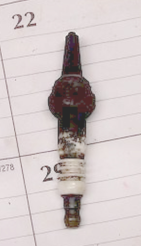

Perhaps you're dealing with the same issue as in this thread - Broken spark plug
I tried to enlarge and "enhance" the one photo posted in that thread. Still a lousy image, but...
Will
JUL 12, 04:45 PM
This wasn't a Fiero. Sometimes S@#$% happens with spark plugs
I was SUPER lucky in this case in that I was able to get the shell out with a fancy extractor.[This message has been edited by Will (edited 07-12-2021).]

If it was like the situation in the thread you referenced, wouldn't the porcelain and hex come out, leaving the threaded part? I thought that's what happened there.
