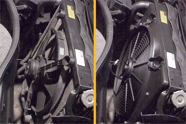

Yea I want to do that but course idk if I type In spal fan it will come up a picture would be awesome if you have one
Larryinkc
JUL 03, 02:51 PM
mafv8
JUL 03, 02:57 PM
| quote | Originally posted by Larryinkc:
Thats exactly what I did, looks just like that, except a used a SPAL fan, works great

Thank you big time for this Larry ordering this ASAP to get rid of that crap stock fiero fan. This will definitely help out big time with cooling at idle. I sit in traffic for a good 10-15 minutes before gettin over the bridge to get to work here on the cape. And all I hear is the stock fan running constantly lol surprised it hasn’t burnt out yet. But this proform fan will help out big time
