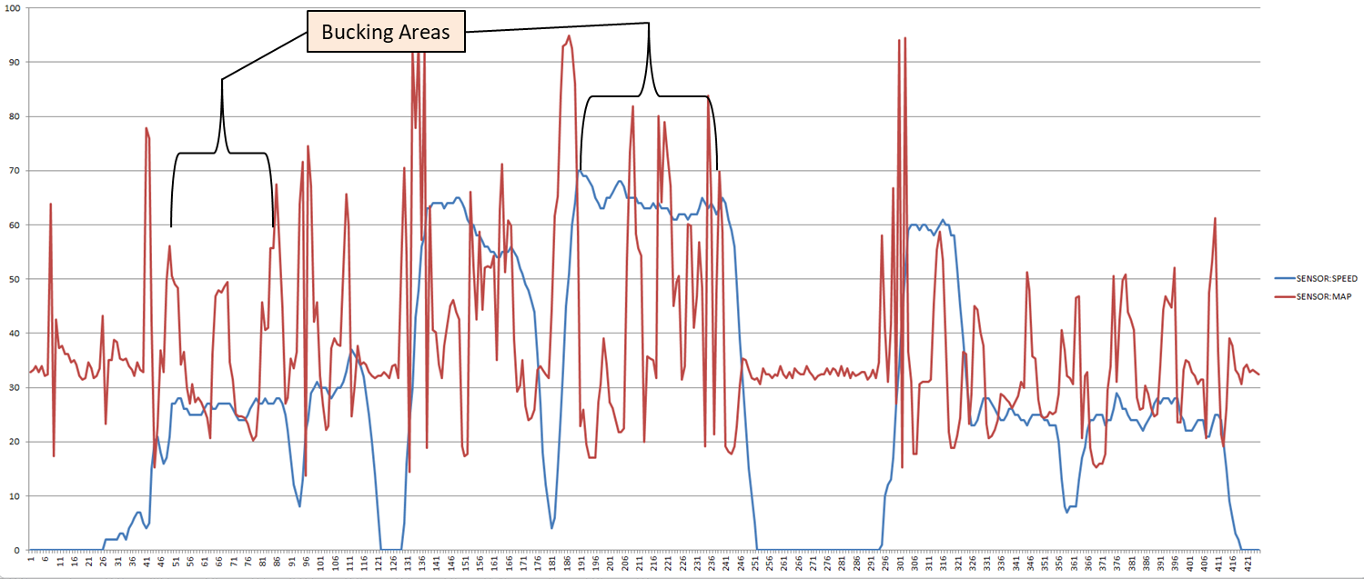

Here's a chart showing the MAP data vs. Speed in a test drive
I don't know if a worn timing chain would cause these problems, but Fiero timing chains do stretch out pretty quickly.
In that datalog, is the MAP going up and down because you're pressing/releasing the throttle pedal, or your foot is constant and the MAP is doing that on its own?

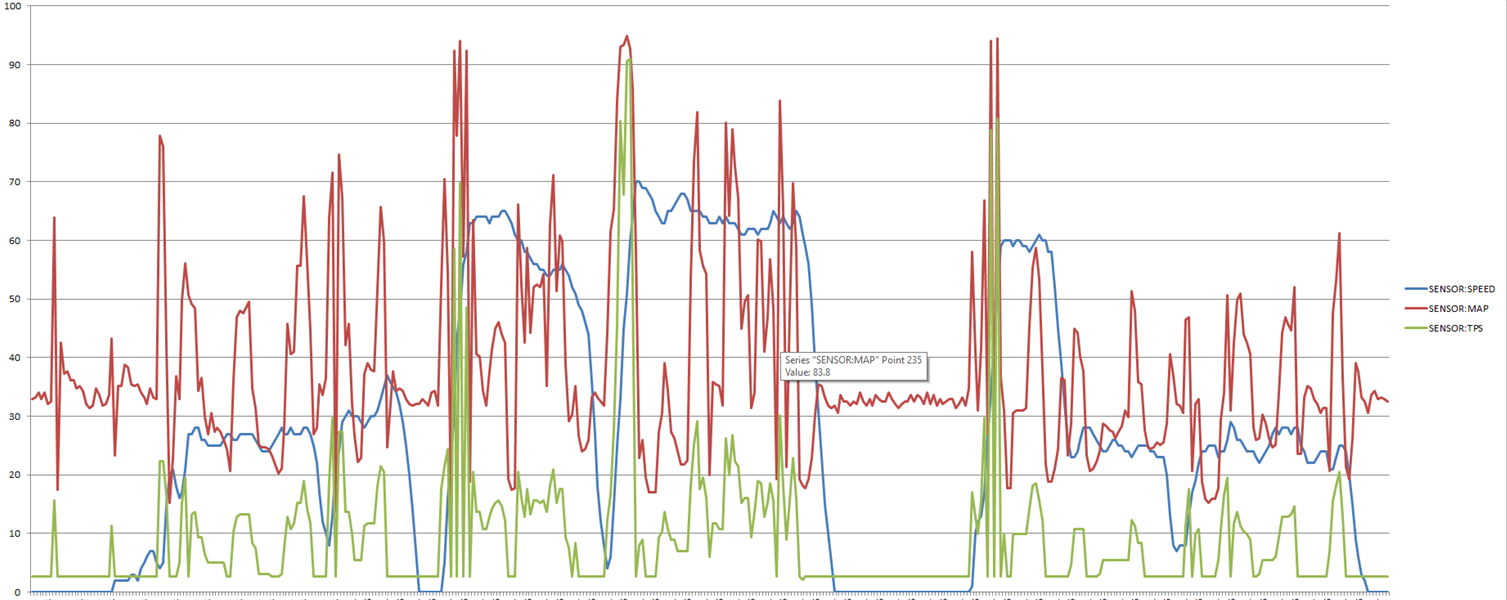

Probably me - whenever it bucks I'll either get my foot off or punch it harder, otherwise it seems to get worse. TPS data added.
