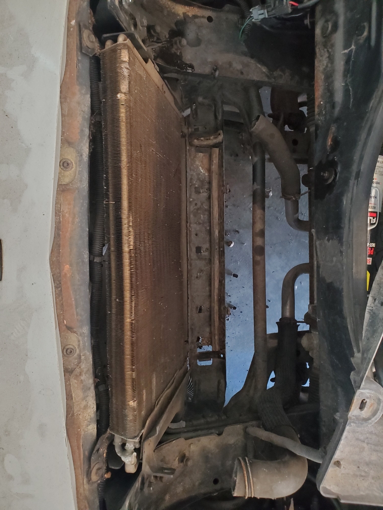

That stated, started taking things apart and moving things where I wanted them to be. Pulled the radiator and cleaned everything up; pre-cleaning:

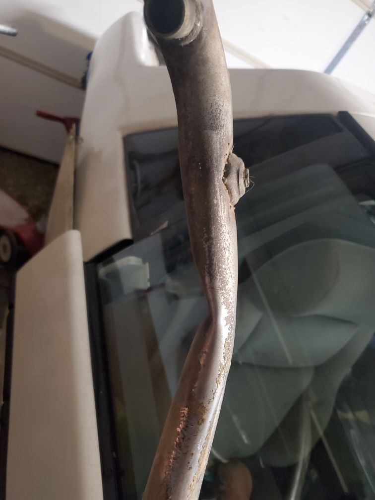

Pulled the passenger coolant tube. I knew I'd need to fix this going in so I already have a replacement section to weld in. I sectioned this piece to see how bad it actually was. . . It was bad. . .

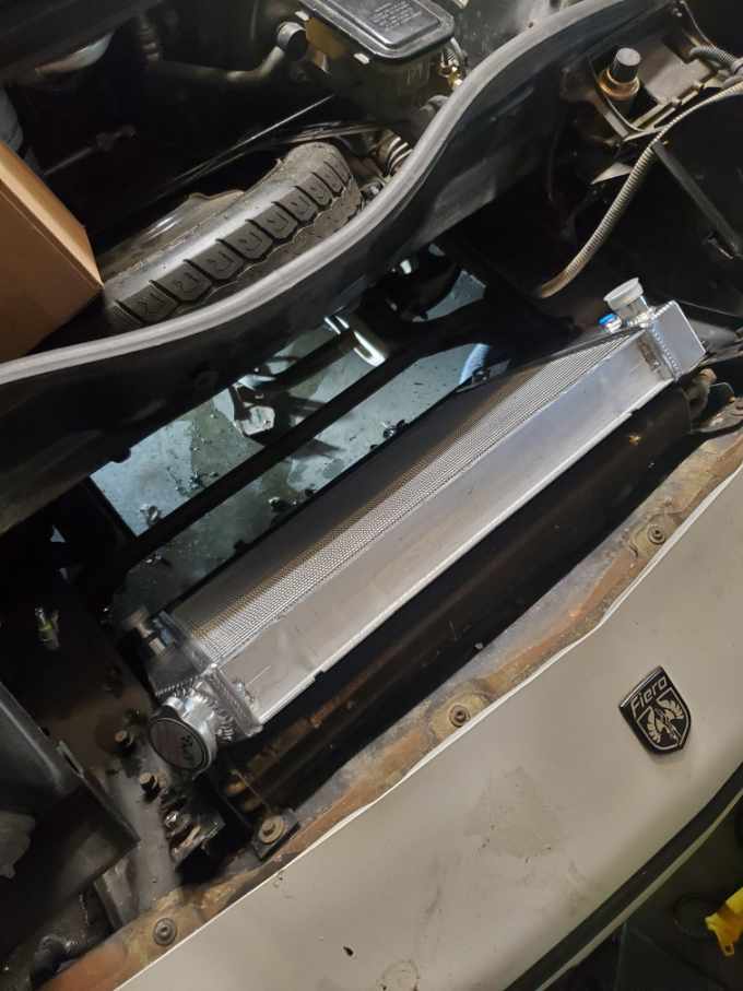

And putting the new radiator in place. I'm super tempted to replace the AC condenser at this point but don't feel like spending the $300 on it yet so I'm going to hold off. Once the SS mig wire comes in, I'll go ahead with finishing cutting the coolant tubes then welding them back into the orientation I need.
-Chop it right at the buckle -Form each side of the cut round -Butt weld back together -???? -Profit!

Use a tig if you can with those pipes unless you are far better than using a mig than I. I cleaned, solarfluxed, and practiced on a similar size stainless pipe, and these 30+ year old lower grade stainless pipes gave me fits repairing mine. Burned through easily and weld kept going porous on me. I finally got it sealed but the weld is so bad I'm going to cut it and tig on a section instead.

I had a really good welder to the repair on my pipes, so I can't comment on how easy or difficult they are to weld. Butt welding thin wall tubing is already a varsity skill.

While a lot easier on TIG to butt weld, you can do it on a MIG if you pay attention. Obviously, make sure you're using the right filler as well as tri gas (He/Ar/Co2) and make sure everything is nice and clean.
I initially tried using an exhaust expander to try and expand some of the pipe so I can slip the replacement in/over the other but unfortunately, the pipe expander broke trying to do this. I think the material is just too strong to expand

Goto Napa, they have sockets with a tapered face that you can use as a mandrel to shape the pipe, just remember to put a long bolt through the socket to use as a slide hammer to extract the socket.
I copied Steven Snyder's instructions here.. http://steventsnyder.com/re...fiero-coolant-tubes/
Worked really well...
I did use tri mix, 308 filler, and cleaned the tubes inside and out....i probably just stink that much at welding. Lol!!
