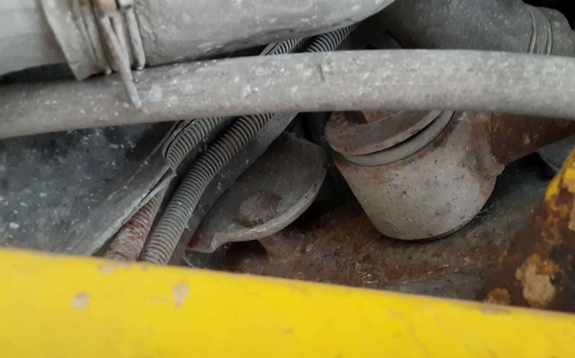

Finally found a possible cause - or maybe just a result - of the clicking and banging. Here's an image showing where apparently at least two spot welds have failed and the layer of steel closer to the smart phone camera has been sliding against the layer underneath:
Back side, as seen from the left rear wheel well. Seam is just to the right of the two wiring protector deals:
The location is behind the driver seat and near the outside of the car. The mechanic who spotted this was able to use a small crowbar and move the closer metal up and down. The counterpart seam on the other side of the car is fine.
I've got an appointment a week from now for the local GM dealer body shop to try to weld. Doubt they can access well enough to drill and replace spot welds, probably wire weld along the seam on both sides, maybe add a short piece of angle steel and weld that over the seam.
BUT, is the failed seam the cause of the noises or one result of the banging? The 3.4 has additional torque, sure, but enough to cause this? I doubt it. Or do these spot welds just plain fail sometimes?
Remember the clicking/banging only occur after a few miles. Drives like a proverbial dream until that with no unusual noises or vibrations. The loudest bangs I could feel under my butt.

If the welding doesn't fix it, check the cradle to frame bolts and that looks like original rubber suspension bushings. Either of those could cause that.

Local GM dealer/suspension portion of service guy/"collision" shop welder guy (and they let me under the car while up on lift before they started and after they finished)
1) welded both sides of "break" illustrated above. Their better lit and angled view of the back side showed an actual gap between the layers of steel. Painted black after welding. I did not see the pre-paint weld, Hope it was sanded/wire brushed/whatever.
2) I asked the body shop guy doing the welding to also test/check around the four corners of the cradle, which he said he did. His words [paraphrased] "I didn't actually use a torque wrench but they looked OK".
Anyway, no clicks or bangs in the last three trips to town and back, average 8 miles one way. I'm still holding my breath.

Sounds like that did the trick. Awesome.

Heard some of the same clicks and a mild bang yesterday. Crap. Much better, but still frustrating/disappointing. Makes me wonder exactly what I'm risking by driving the car. Takes the fun our of driving. I wonder what caused the spot welds to break in the first place.
What do you think about taking the car in to the last shop which actually lowered the cradle (I assume they would have had to) to replace the oil pan gasket and install new water pump, new belt, and new gasket around water pump etc. belt cover. All the leaks were fixed, but the click/clank/bang noises started after that work. Ask them to check each corner of the cradle? The GM dealer welder just looked at the cradle bolts and said they seemed OK.------------------ John W. Tilford
