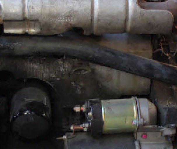

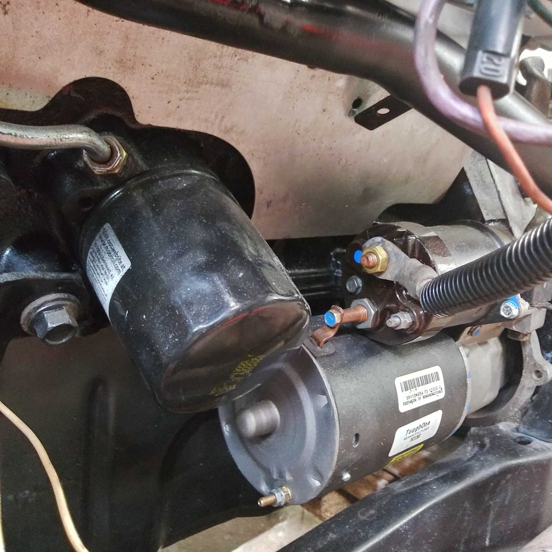

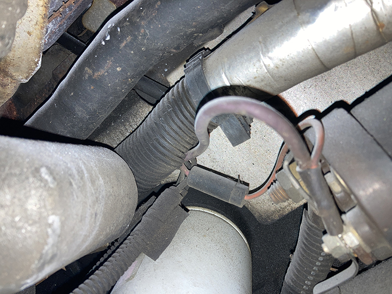

 It's clear now where the two outboard mounts go (see photos) but it's still a mystery to me how to attach the center mount and what to. If you check my photos, and compare with the diagram sent by IMSA GT (thanks for that, BTW--it got me started toward success). It seems to almost--but not quite--line up with a hole in the starter heat shield, and perhaps a threaded hole in the engine block under that (can't see now with the shield held in place under the remounted exhaust manifolds. BUT they don't line up on the same plane: the angle of the screw hole in the pipe bracket is pointing at the shield (and block) and an angle--not perpendicular to the plane that they are on. IMSAA GT, your diagram seems to show it the middle mounting hole attaching to a bracket that hold the wiring harness in place. If that's true, I haven't yet properly figured out how THAT mounts, but the diagram, views C and D, seem to show the middle mounting hole on the coolant pipe oriented in parallel to the pipe, and attaching to the "side" or that wiring harness mount. By that I mean, in the diagram, it appears that hole lines up with a stud whose axis is parallel to the engine block, not perpendicular to it. As you'll see in my photo, my hole points right at the block (though not perfectly perpendicular, as mentioned above), NOT parallel to the block. Thanks, guys for all your patient guidance. And I thought I had taken enough pictures......

          | IMSA GT, you have been sooo helpful. I really appreciate it. What's going on with that third, middle hole is still a mystery to me, and with yours quite clearly cut off, you can't be expected to know. That photo you gathered from the web is, unfortunately, inconclusive also. I'm thinking, screw it! Unless something obvious rears its head as I do the cradle re-install, I won't worry about it. The pipe's secure. It's possible that's a mount point for some other thing, I just have no idea what. I may come back to ask questions about wiring loom routing and bracket-hanging points if my disassembly photos are deficient for them too. I must confess I am not used to working this extensively on cars with this much "systems" complexity (wiring, sensors, endless vacuum plumbing), and so may have overestimated how intuitive it would all be upon rebuild. To put that in context, my other recent Pontiacs: 78 Trans Am and a 69 GTO...so elegantly simple and straightforward (especially the later).
