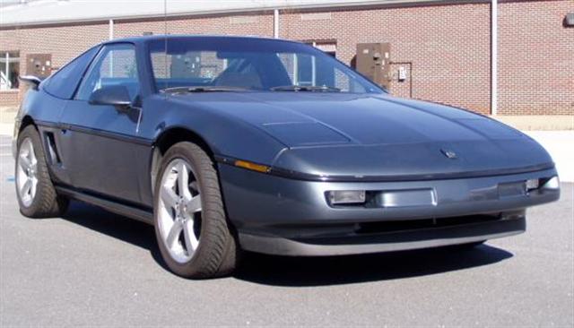

The white car has the 38mm front offset.

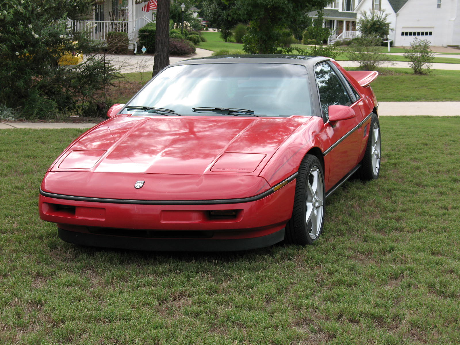

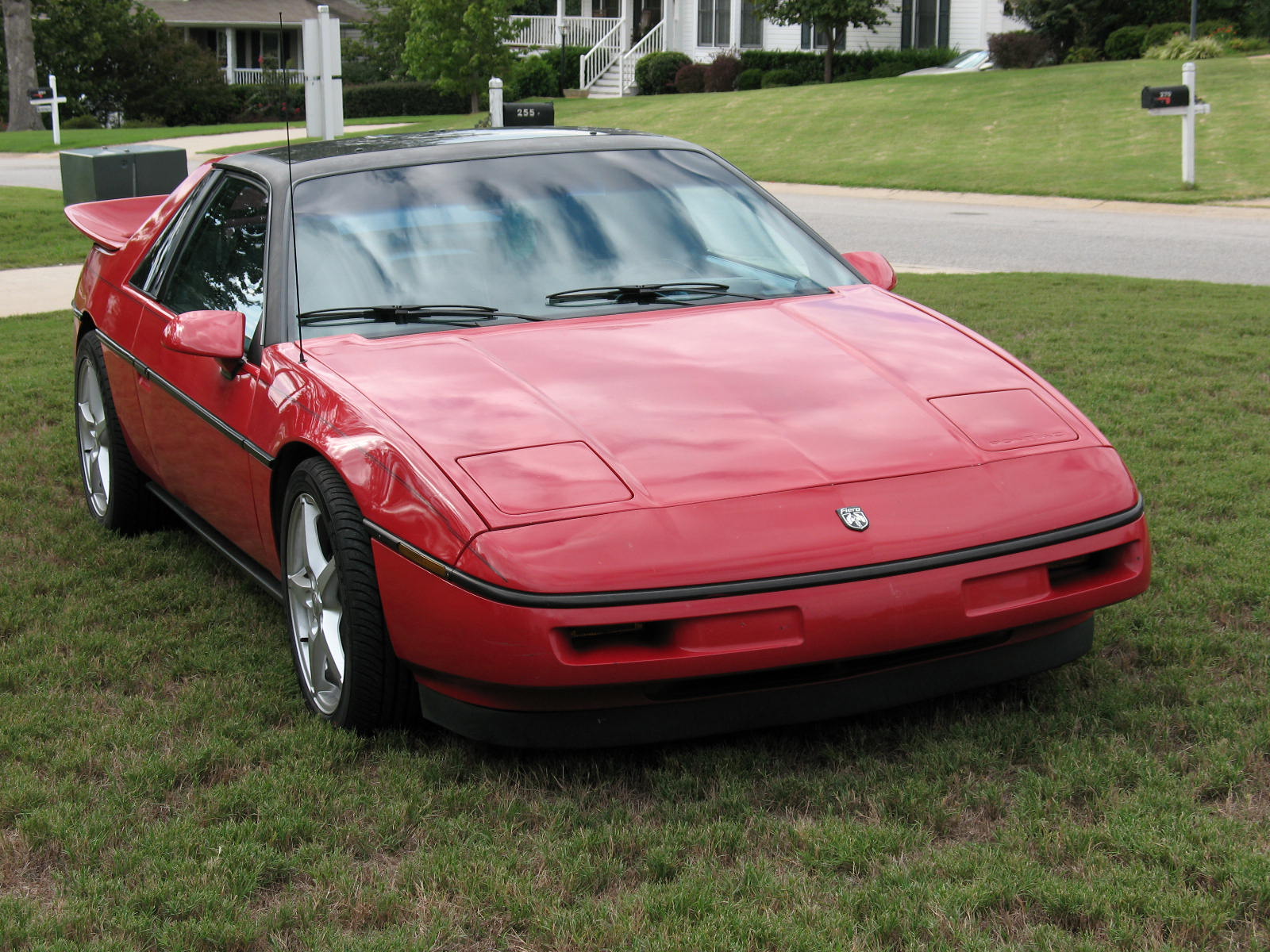

The red car has the 48mm front offset. (These are the same wheels that are now on my gray car, but this is a better pic.)
Front pics. 48mm offset.

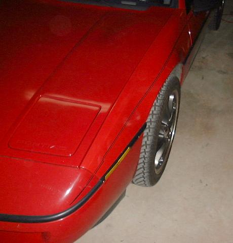

Front pic 38mm offset.
