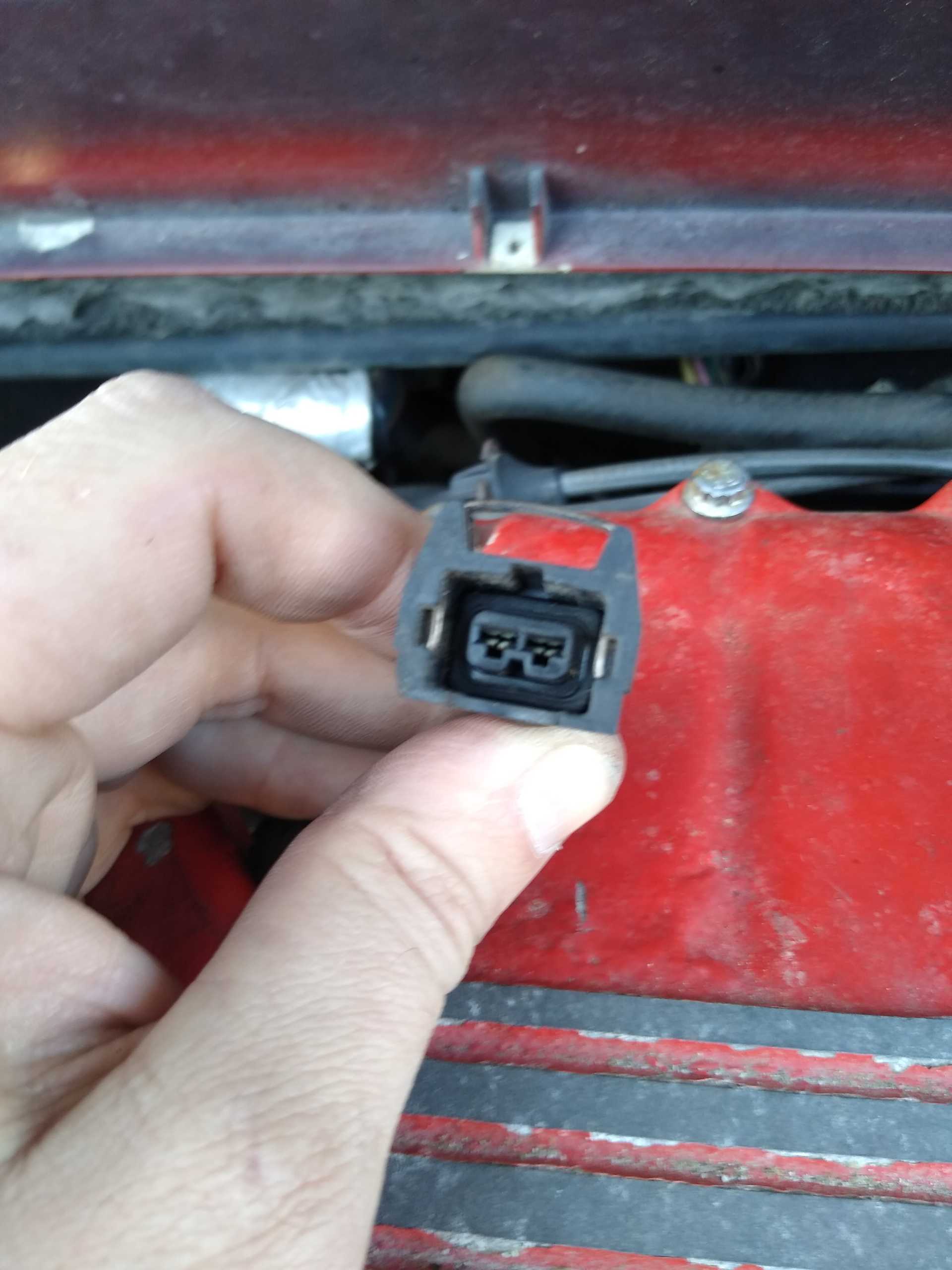

| quote | | Random not connected to anything electrical connector....What is it for? |
If you can unwrap the wire loom a bit and clean up the wires you will be able to see what colors the wires are. That should help you identify where it is supposed to go.

I can do that. Seems odd that a pretty decent size plug is taped up and hanging on the backside of the plenum. I should get a multi meter on the pins to see if there was s voltage.

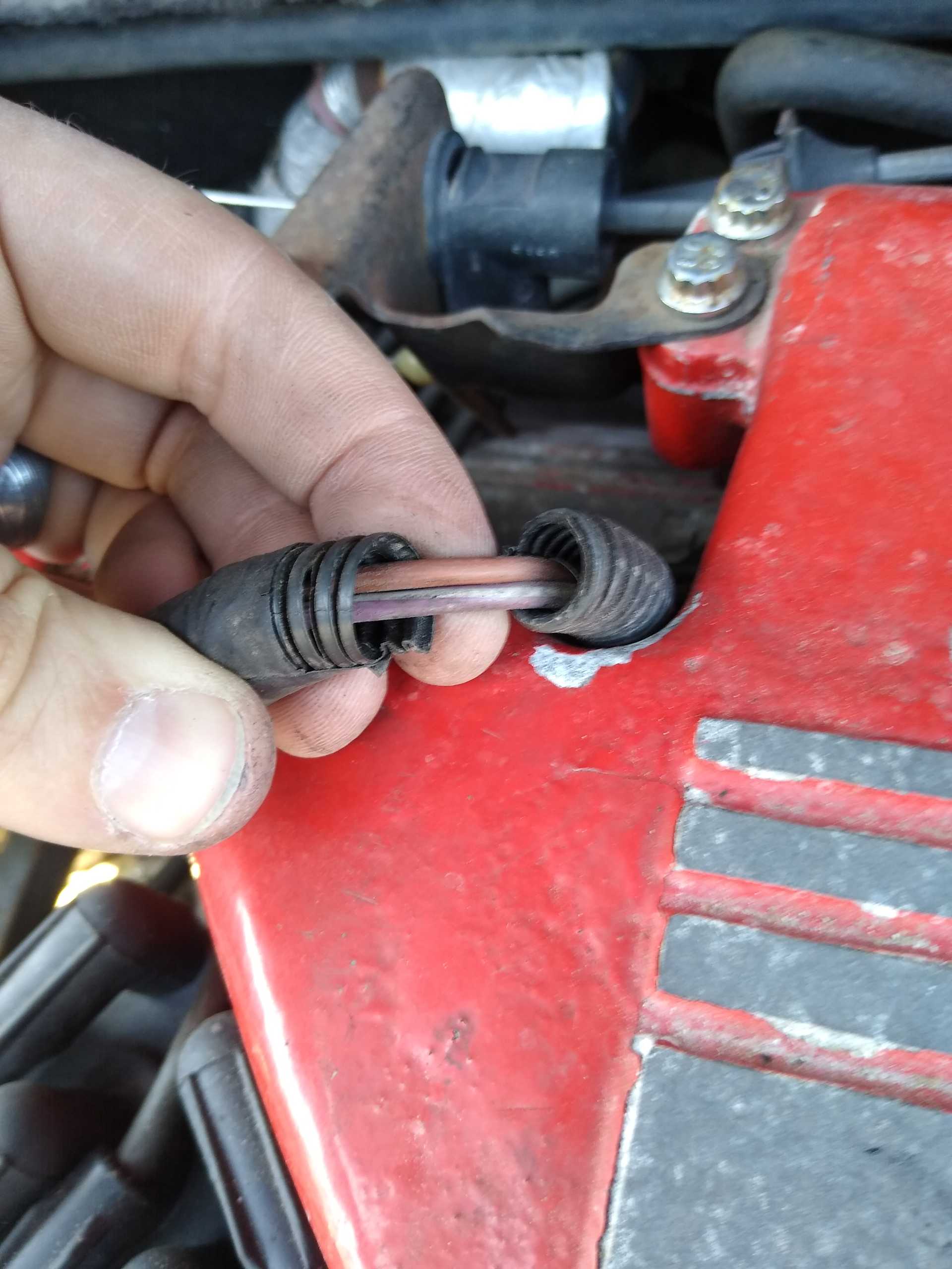

Ok....Whew....Yep that ground was loose. I now have tail lights!. Also, amazing how that ground probably helped it run better. It ran better after new vac lines, I also did a quick fix and sprayed the hard vac lines with flex seal. Temp fix just to see if there is improvement by quickly plugging any and all pin holes. Yep , it starts better, runs smoother, less stumble, and no hesitation now. Question though. If it runs for a while, you shut it off, Let it sit for a few minutes, then come back it does not want to start until you try it a few times then it just pops off and purrs like there was no issue. Very strange.
Also mystery plug has been unwrapped please see photos.
Purple/white stripe, and orange is what the wires look like.

I believe the "mystery plug" is for the cold start injector.
The reason there's some confusion on the unplugged tube running along the firewall, is there were two different designs. The early design the metal tube plugged into the intake snorkel. The later design plugged into the side of the air filter canister.
During the recall, if memory serves, the early design snorkel was replaced with a new snorkel that had no inlet for that metal pipe. Thus the pipe was open on either end and didn't need to be capped.
The later design that plugged into the air filter was ignored and not capped off as well even though it fed directly into the filtered side of the air filter canister thus allowing unfiltered air into the engine. For that design, the best way to handle it is to put a rubber cap on the air filter canister in place of the rubber hose that went from the canister to the abandoned metal pipe.
