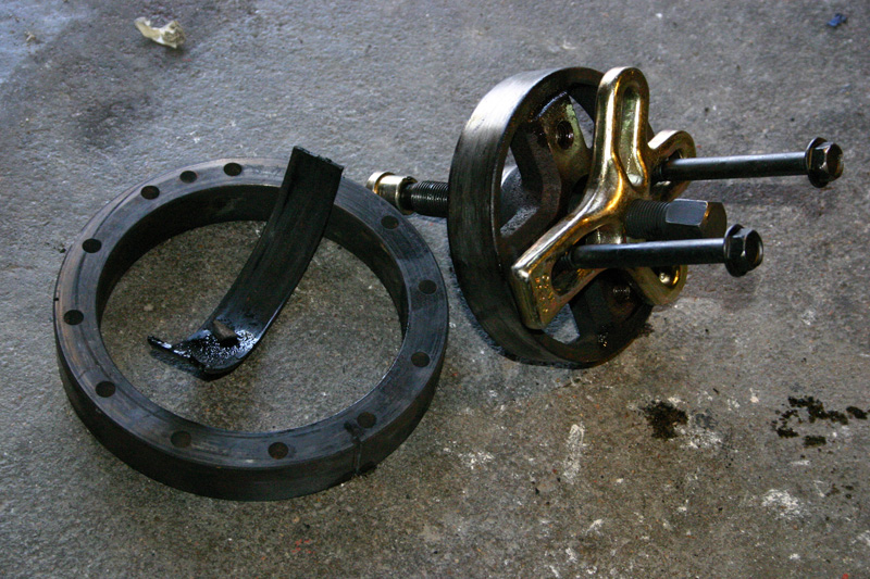

I happened to come across the following image in an old thread. This is the eventual outcome when the harmonic balancer hub and outer ring decide to go their separate ways!
