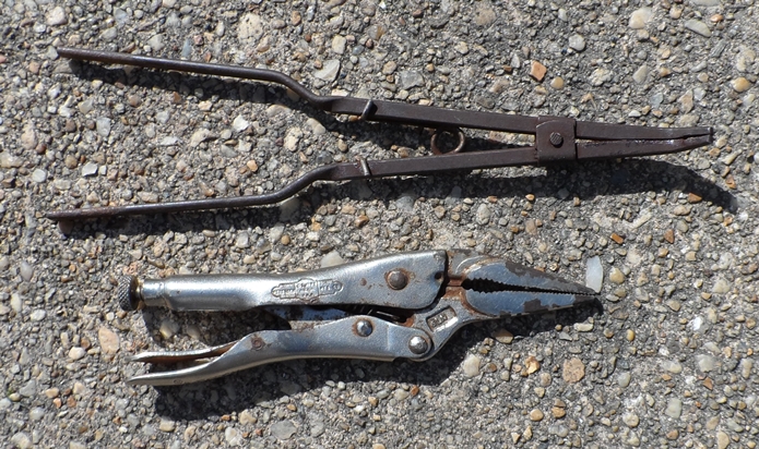

| quote | Originally posted by cvxjet: To hold a nut where your fingers can't fit, get a pair of Hemostats.....
Mostly those only works w/ small to very small things even ignoring clamping/locking "ears." Big things and open the tool to grab gets wrong angles to hold.
"They" make other versions for mechanics etc that hold bigger things. Like...
 top works up to 1/4" (Old tool w/o marks easy to see.). short visegrips to grab ~ 1/2" at the tip.
Can use magnets and magnet tip tools but they have issues/problems too.
