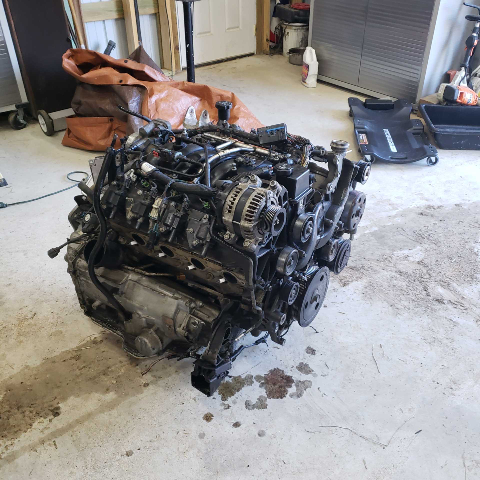

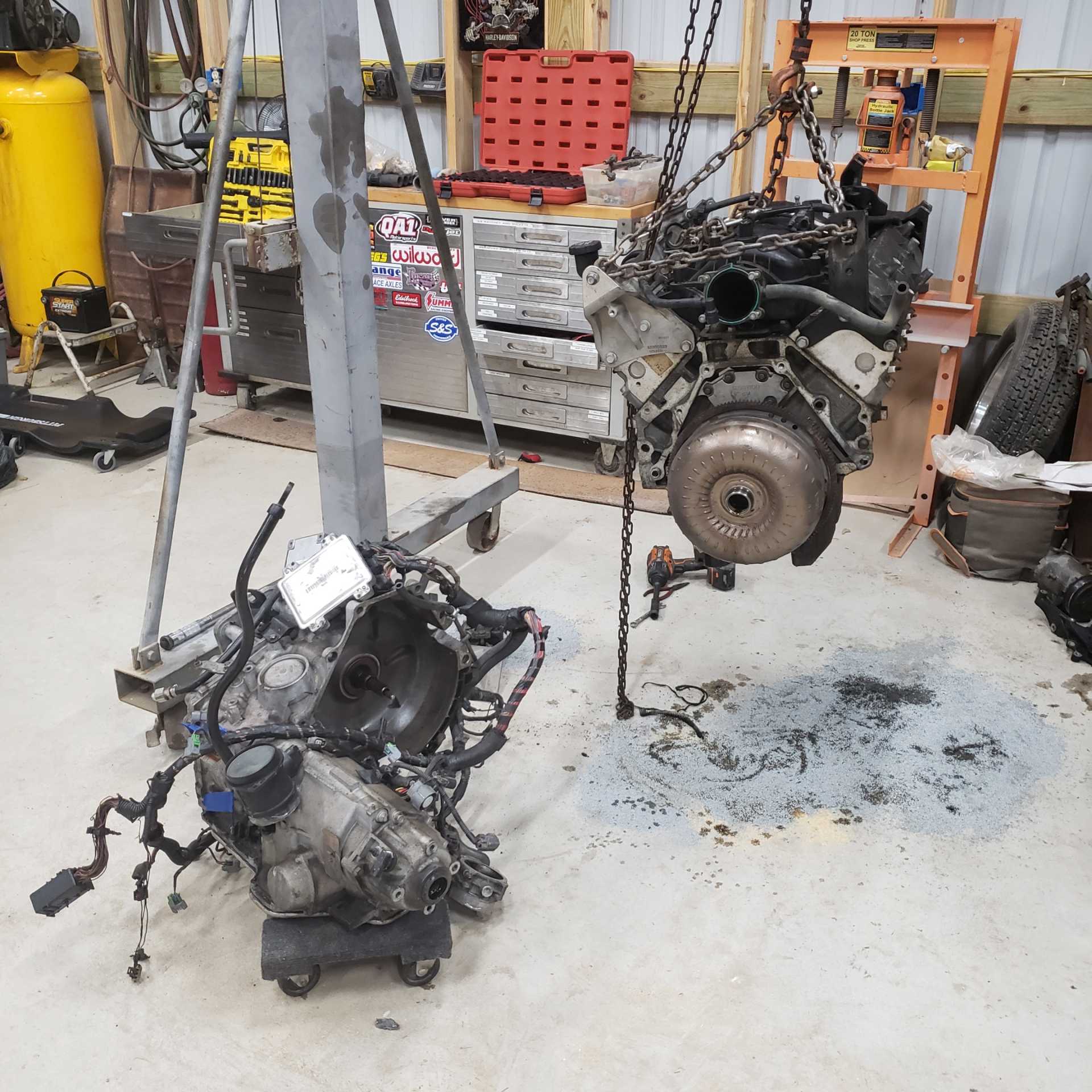

Finally got some work done. Engine and trans is out of the GXP and separated. Time to order some parts!

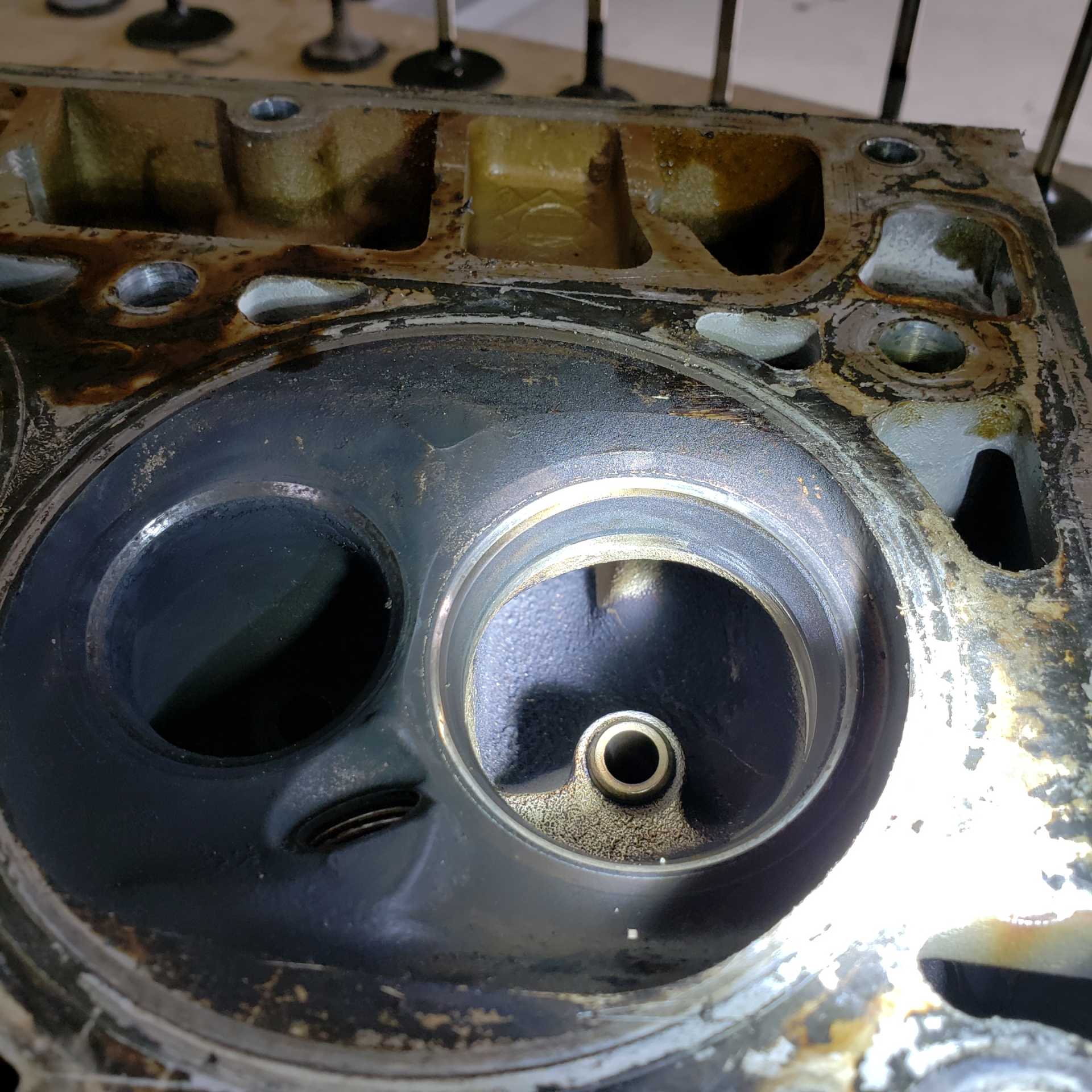

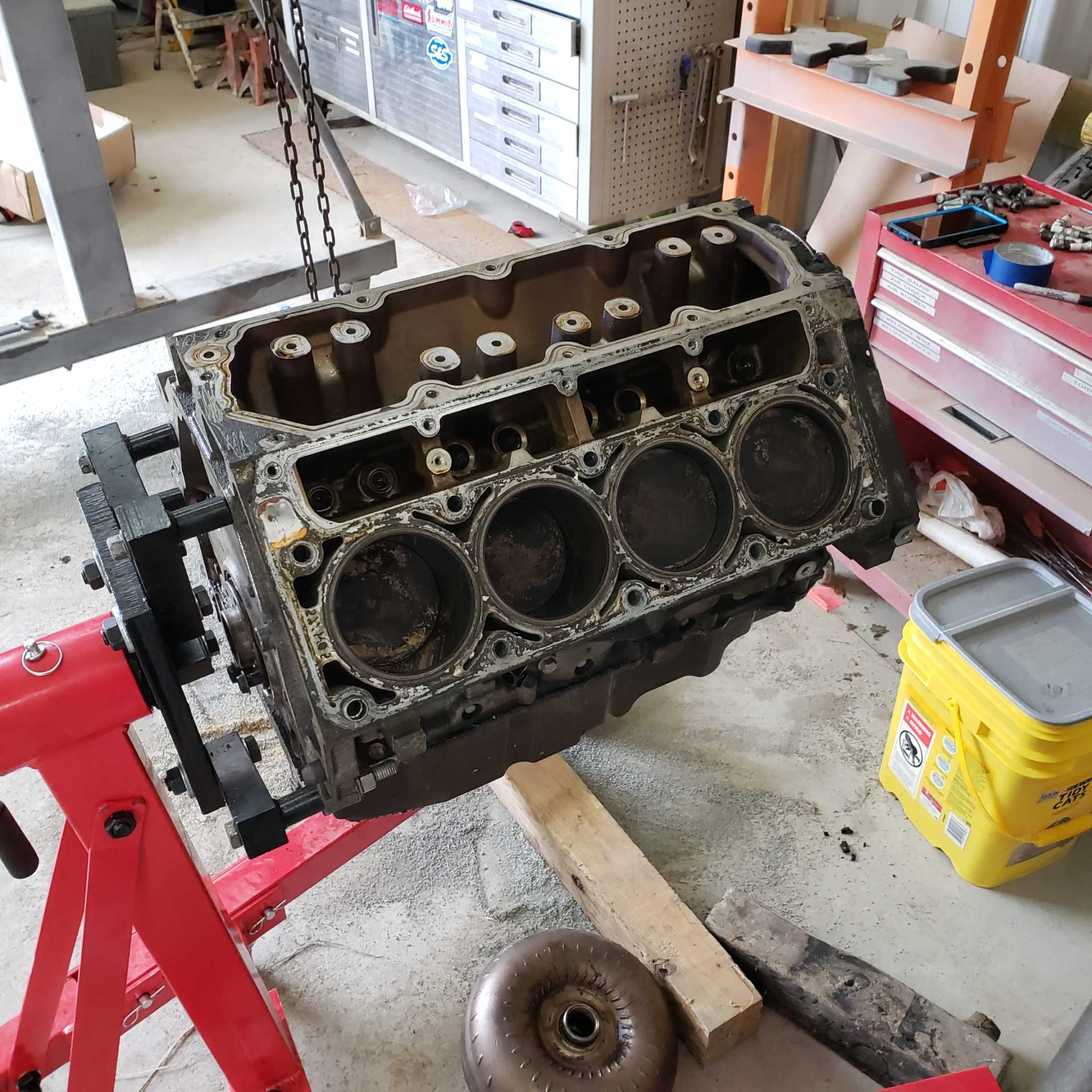

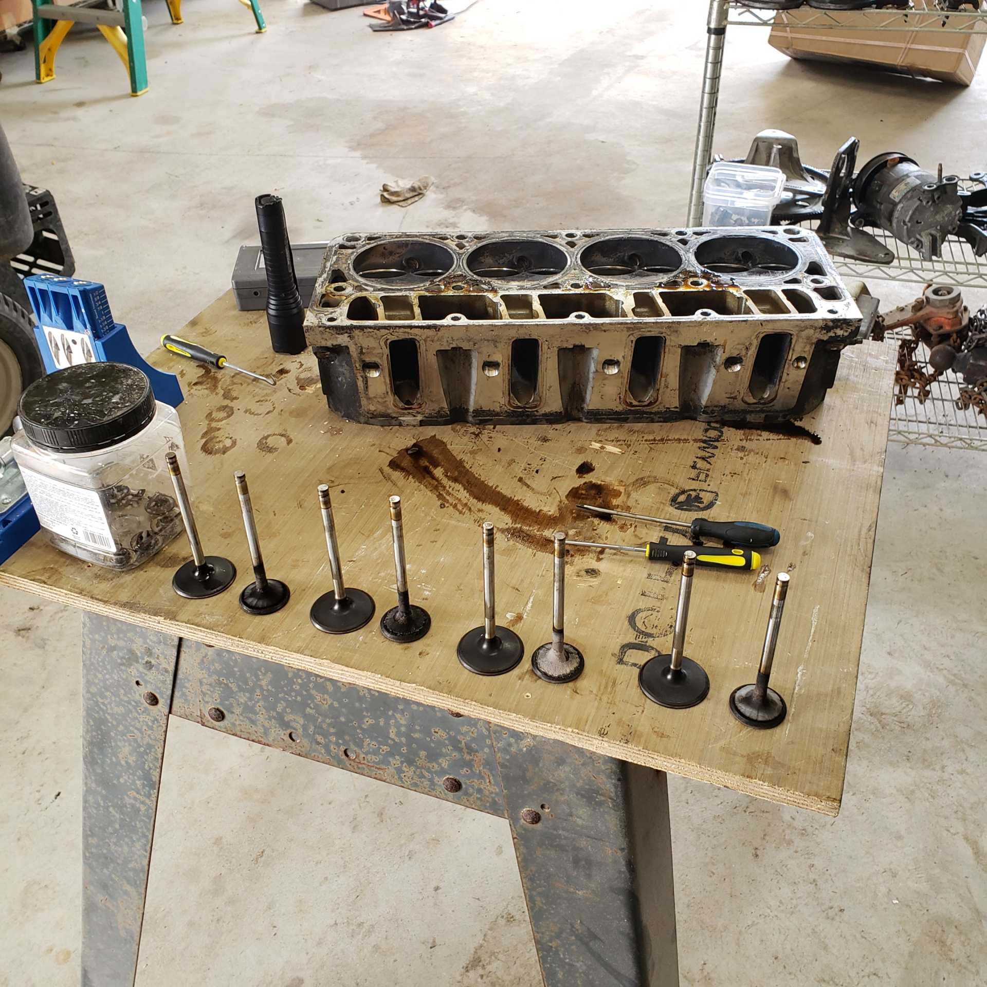

My grandson came over a few days ago and started helping me. He's 12 and willing to learn so I'm going to give him some education about engines and this project. We got the engine torn apart today and will be porting the heads tomorrow while we're awaiting parts. More to come...  [img]http://images .fieroforum.com/userimages/JC86GT/20210320_162417.jpg[/img]
