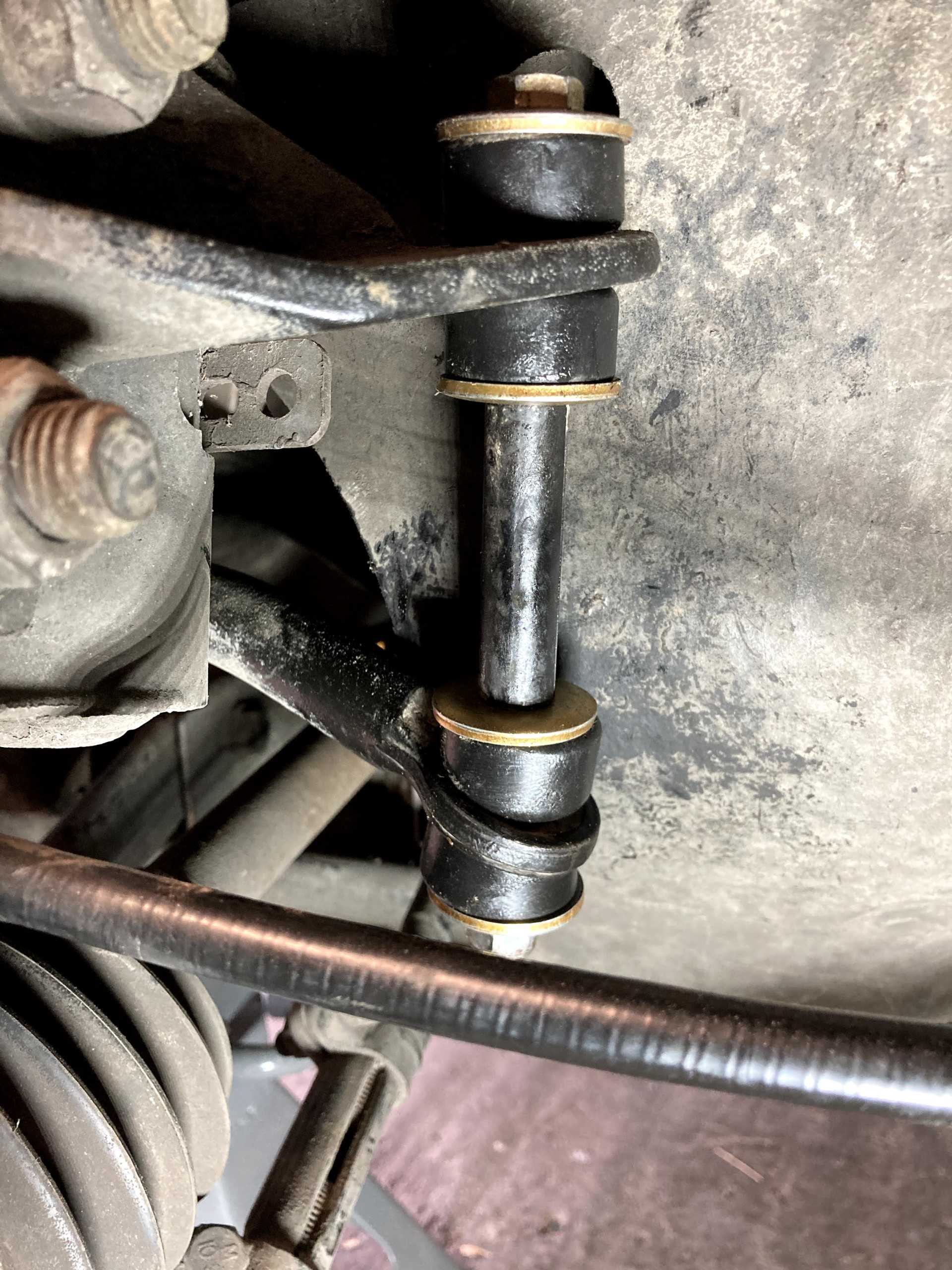

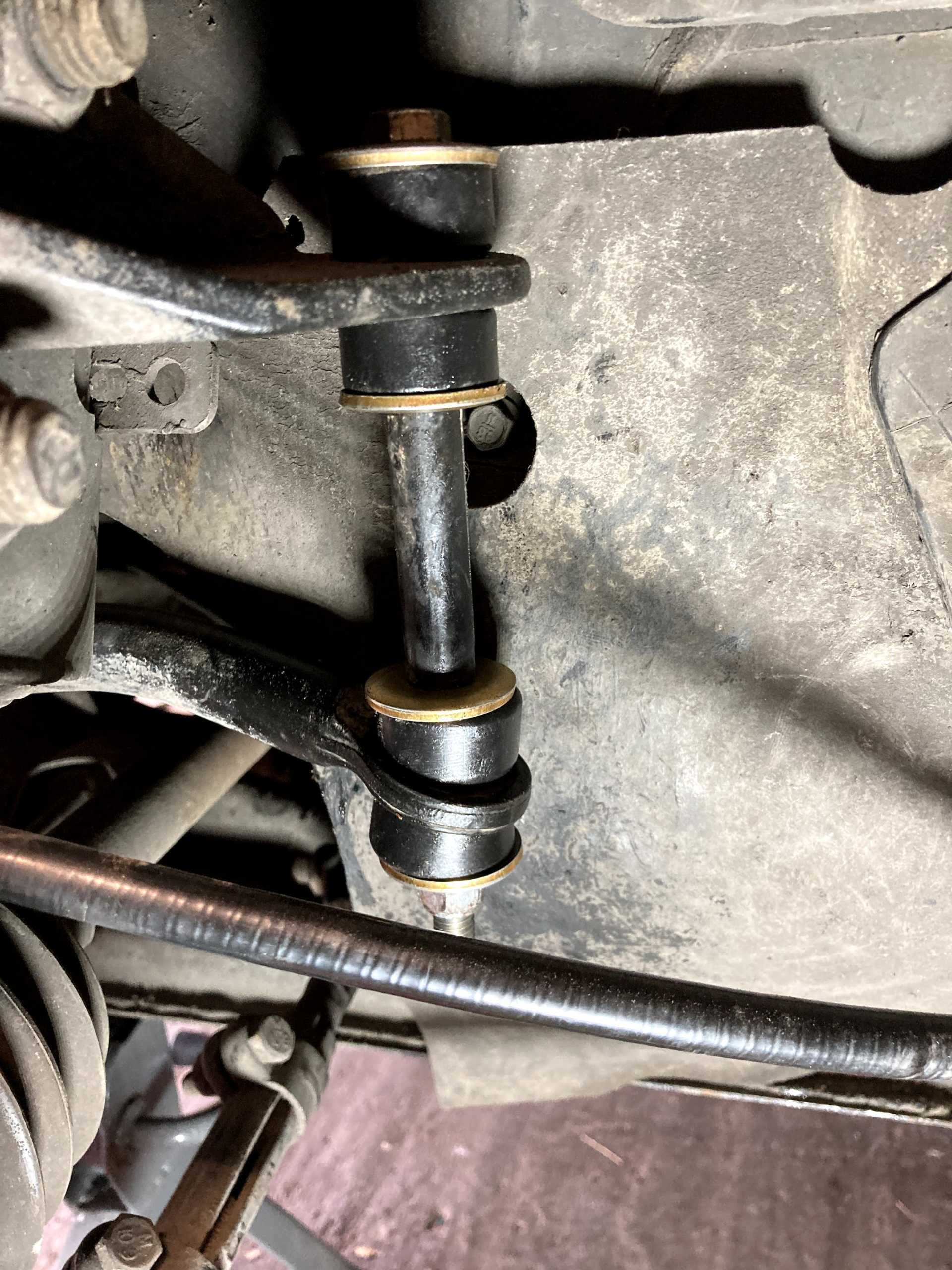

Well boys I decided to swap in the old spacers because they fit easier, were stock, and appeared to be fine. I realized I had the bushings on upside down, so the flat side was facing the sway bar and not the rounded side.
It probably doesn't matter. I won't be on any autocross courses anytime soon.
Here are some photos of uncompressed vs compressed suspension.
She'll run just fine. I've got other things to worry about.
Thanks for the help boys
fieroguru
FEB 19, 07:59 PM
Your sway bar is installed properly. The notch in the bar is to clear the rear transmission mount which yours does.
You can always cut down the center sleeve to level the ends out at ride height. You might need to get a shorter bolt depending on how much shorter you make it.
