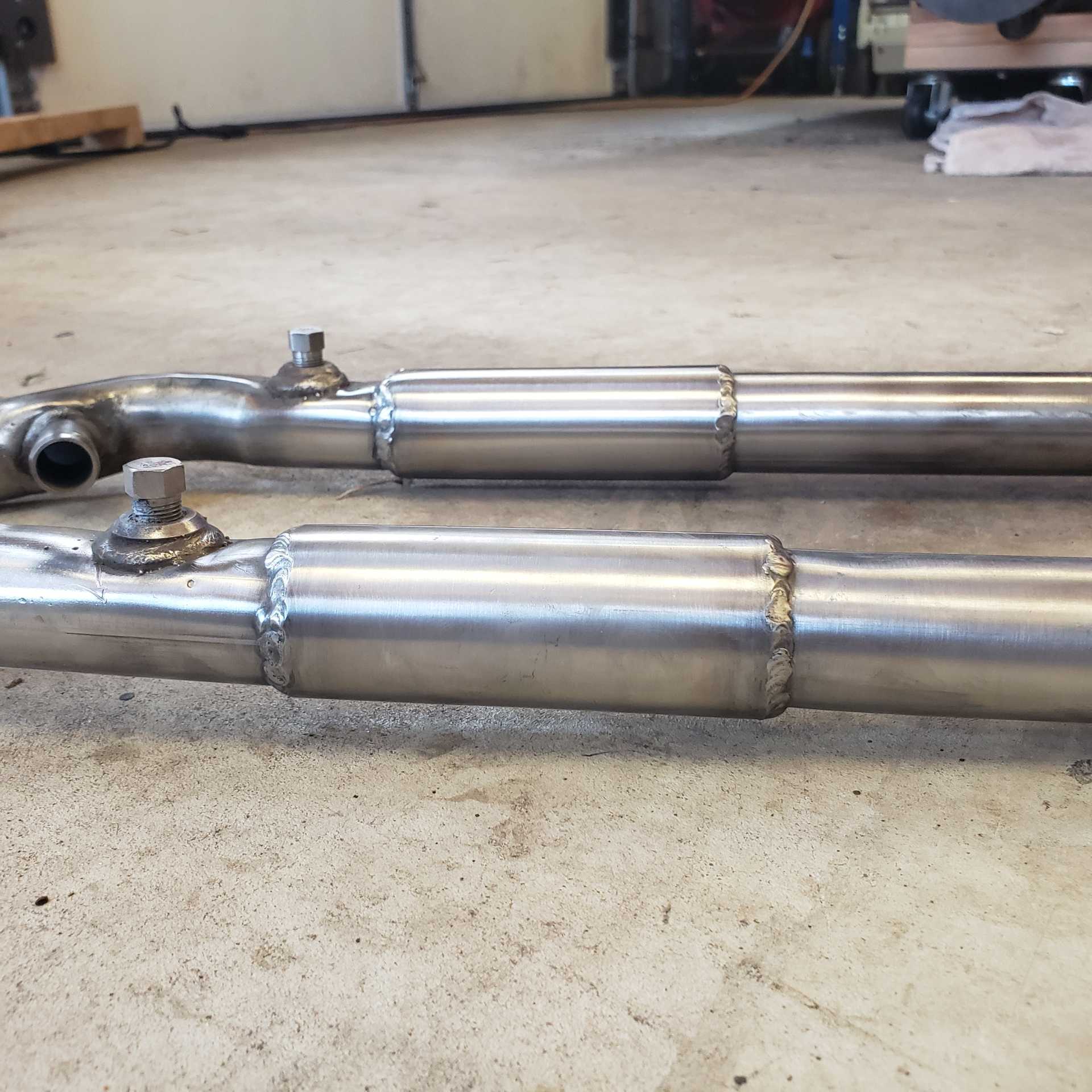

I just turned my pipes over to a welder today. I expect to have them back end of the week. I have high expectations. I'll post pictures of the finished job. My pipes weren't leaking, but we noticed a few minor imperfections here and there in the pipes. The welder is going to fill these spots. The pipe will be sanded down and should look next to new. We'll see.
oneinch
FEB 16, 12:56 PM
I just picked up my welded and repaired coolant pipes. I'm am completely satisfied in everyway with choosing this repair method and the welding that was done. Cost was just under $350; $320 for the welding and under $30 for a repair pipe from McMaster Carr. This price is extremely competitive to the DIY repair tubes from Rodney Dickman. His pipes will 100% make the repair and would have been less expensive ($300 + shipping), but I wanted a welded solution. Sure, there are even less expensive solutions. This could be considered the high end on the repair scale.

Glad you're happy with the result. I'm a bit confused why such a big patch was needed for just a kink. Did he give a reason why he couldn't cut at the kink and just weld once (Rather than twice) after straightening? Would have looked nearly perfect without the added turbulance of multiple changes in diameter (small, big, small).
Also $300 seems excessive for just a couple seems. The local welder I used before COV19 would give me an hour of welding for $150. This shouldn't have taken more than 15 minutes.
oneinch
FEB 17, 02:54 AM
The reason for the big patch is because you have to cut out the crushed pipe. Cutting through the middle of the kink, trying to reshape the tube, and then butt welding it back together - while possible in only a perfect world - is not the way to do it. You'd never get the two pieces to match up. Four inches or so was cut out...back to round tube. The repair pipe is 1.5" OD / 1.402" ID is a little bigger and slips over the original. Hence the two welds . If there was a turbulence scale it wouldn't even register. It's now twice as good as it was, if not better. As far as price, your price may vary. I guess I hired the most expensive welder in the world. Que sera sera. ------------------ Stanton '88 Formula, red on gray

| quote | Originally posted by oneinch:
I've had exactly that done... it's not that difficult.
oneinch
FEB 17, 10:00 AM
Sounds like I'm being challenged. It's the nature of the internet. Between the two methods the way I had it done is stronger and superior. I'll take best over good every time I can. ------------------ Stanton '88 Formula, red on gray
