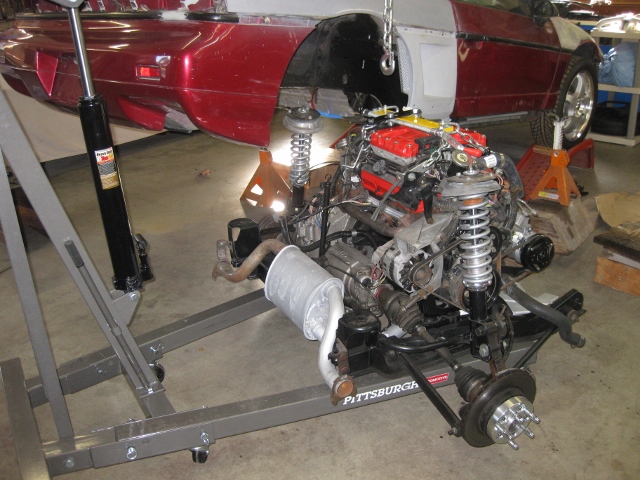

I read somewhere that you don't need the cradle cart. So after removing the engine in the "mini wide body" car using a cart, I decided to reinstall it using the legs of the hoist as the cart. Really worked well. I'm sure the motor can be removed using the crane legs as the cart as well. A couple pictures of the process are included. A few more pictures are on page two of the mini wide body thread. Oh, by the way, the front wheels were raised on a set of ramps with some wood chocks bolted to the ramps, for safety. That reduced the angle of the car while raised for the engine removal. Felt safer to me!

That's very slick bjc 350. Good execution. I've invested in the cart, doesn't mean I have to use it though. I still have all the little things to do first. Drop time is coming. ------------------ Stanton '88 Formula, red on gray
