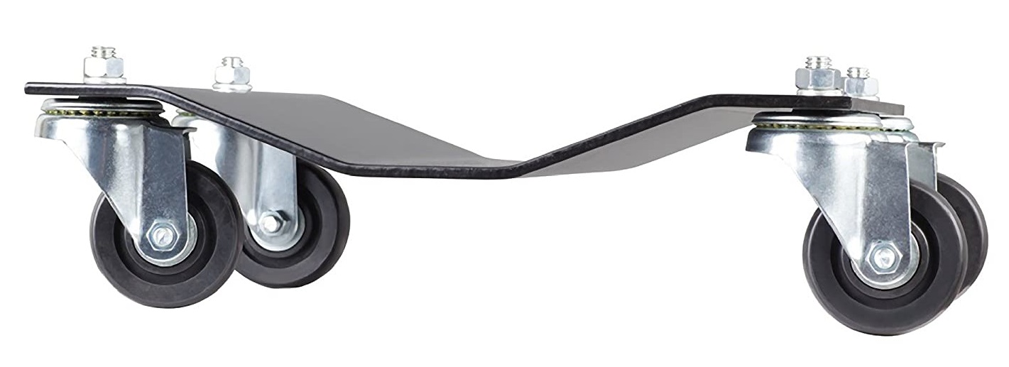

2 large moving flat "carts" will do that but get ones w/ good wheels.
But Most at HF Walmart etc have crap wheels and won't steer even loaded < ½ of capacity. Main issue isn't actual wheel but caster "bearing" at top.
Their "small" and "cheap" and can use then elsewhere and store easy when not needed.
Notes:
Don't leave loads on wood carts. Even above may look strong but can warp under load and easier gets soak w/ oil coolant etc.
If have to work on "blacktop" then don't leave carts w/ load on the pavement or can sink into it overnight. Many Jacks and other things have same problem covered in Cave.

It's funny that the small wheel dolly/skates have been mentioned. After looking at local and other on line options my plan is to get this pair on Amazon (Pentagon Tools 5061 Tire Skates 2 Tire Wheel Car Dolly Ball Bearings Skate, 12" (Pack of 2) Rated at 6000lbs) which are $78. Beware the cheaper set also by Pentagon with the poor quality casters. These skates will add a few inches to jacking up for clearance but I like the idea of them being easy to store, plus I don't need to build them myself.
