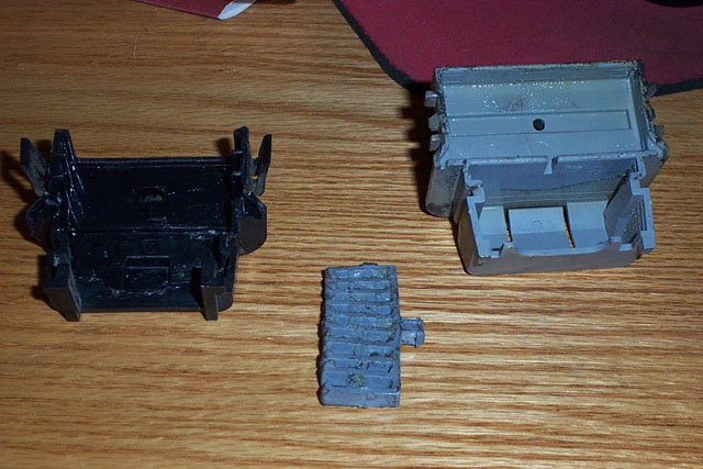

What the separated pieces look like.

How do you get that clamshell back thru the firewall? i had some trouble getting the clamshell back together until i realized that the rear slides together the front snaps. But i am having a bear of a time getting the rear clip on the clamshell. Any tricks?

The black side hooks in while the grey side clips in. You have to put it in cockeyed to get the black side to hook, then rotate it into the correct orientation to get the grey side to clip in. Then you can install the retainer.

Thanks Will. Much obliged jon------------------ Astronomy says we will find a coded signal from outer space. Then we'll KNOW that life exists there, for coded signals aren't by chance.
