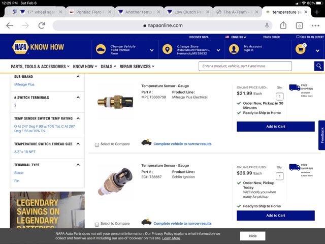

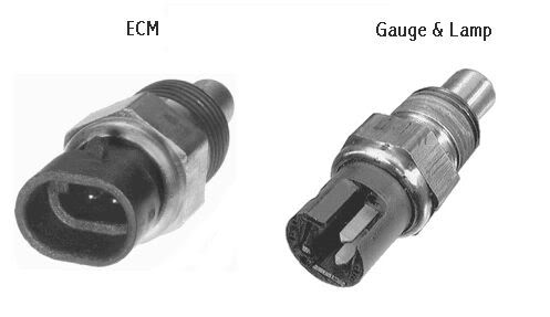

            Many auto parts stores have this part confused with the sensor for the computer.

            Try Napa
  Don’t use sealant or Teflon tape on the threads like the picture above indicates. Be sure to clean the threads on your block with a pick. You need metal on metal good contact.

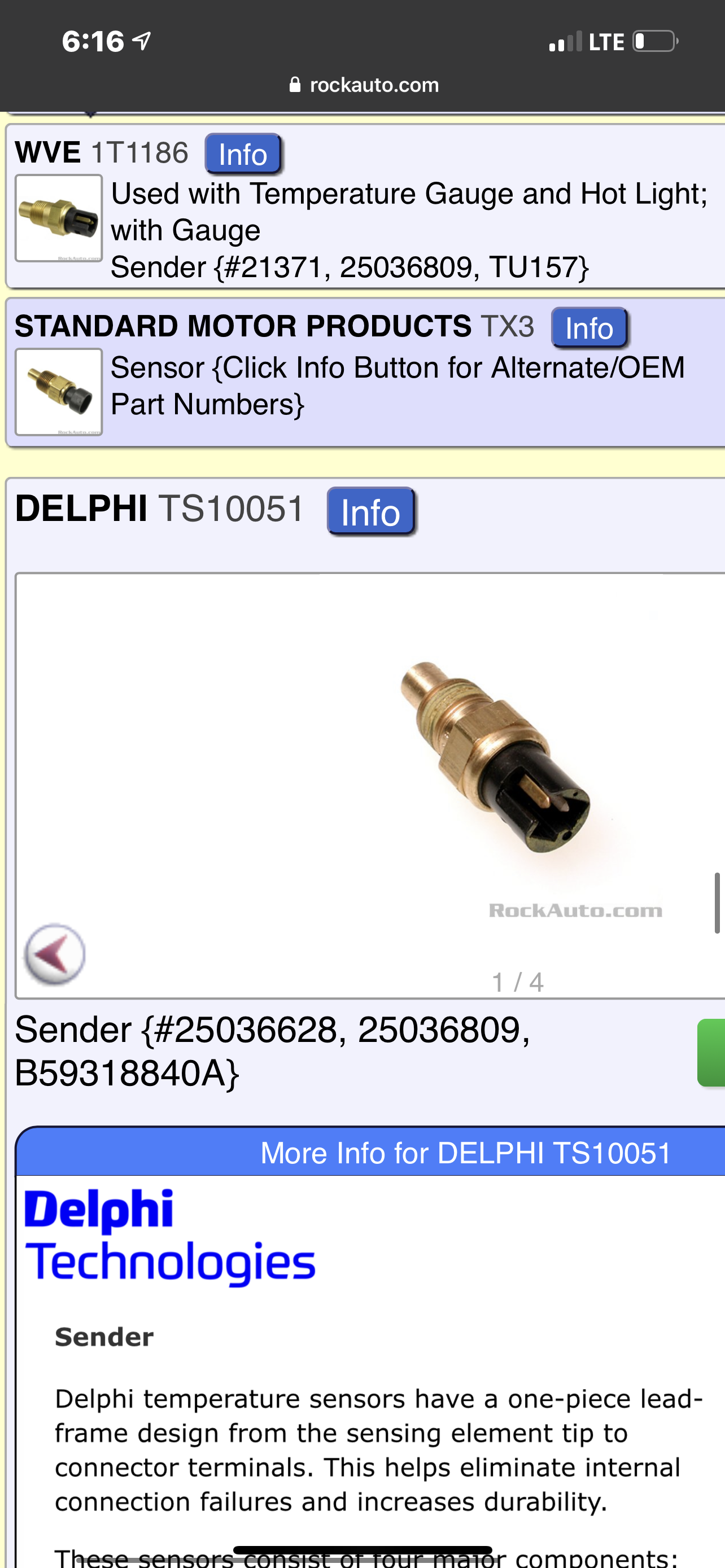

            Thanks. I ordered one from rock auto that looked like the plug but  when I received it’s not like either.

  Here is what I ordered.  They sent me a different one. It looks like it’s the correct part. I’ll email them to get it replaced.

  Regardless, like you did with your pix above, I find it handy to do my homework in advance and come in with a picture or a part number and show them "I need this." Keeps the stupid to a minimum.
