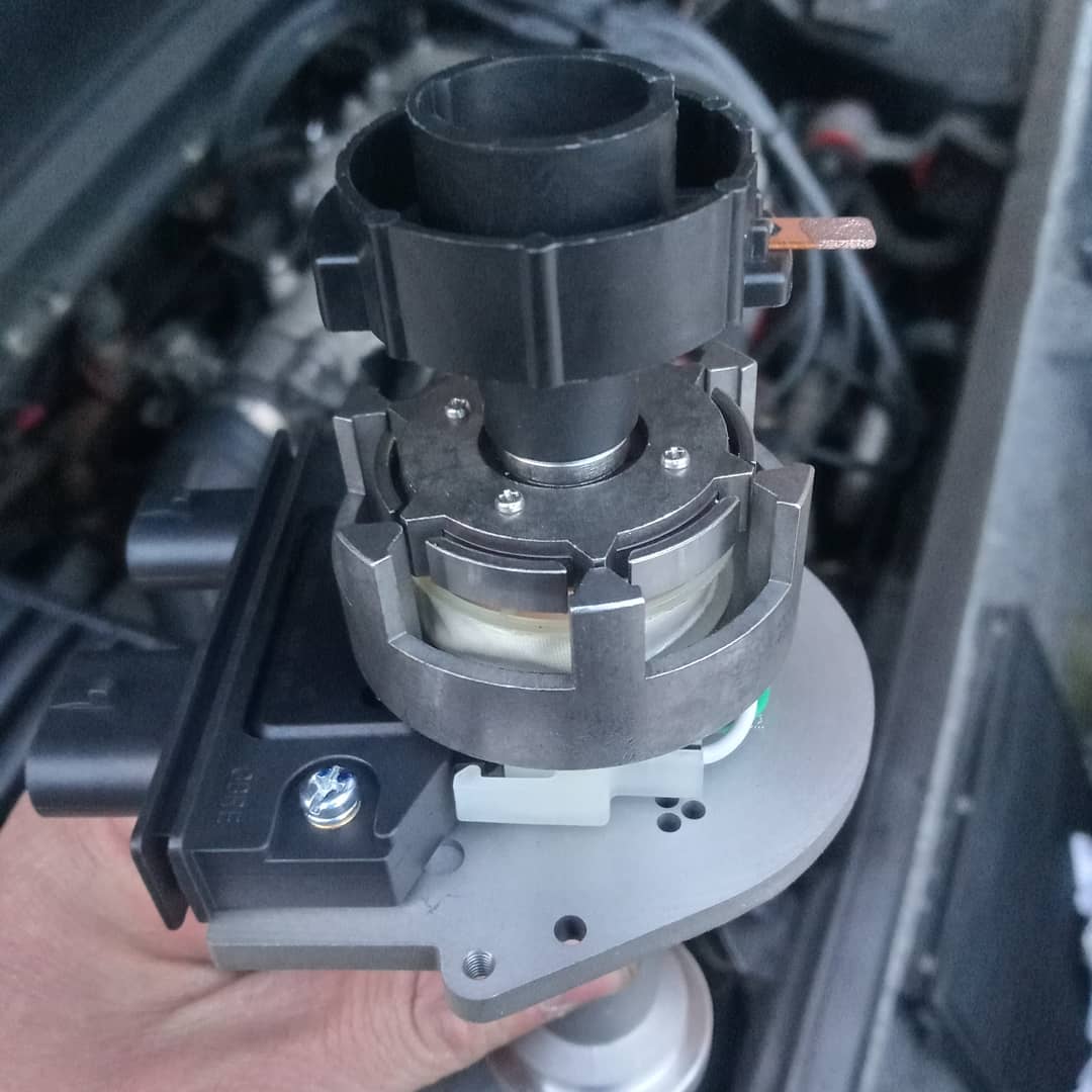

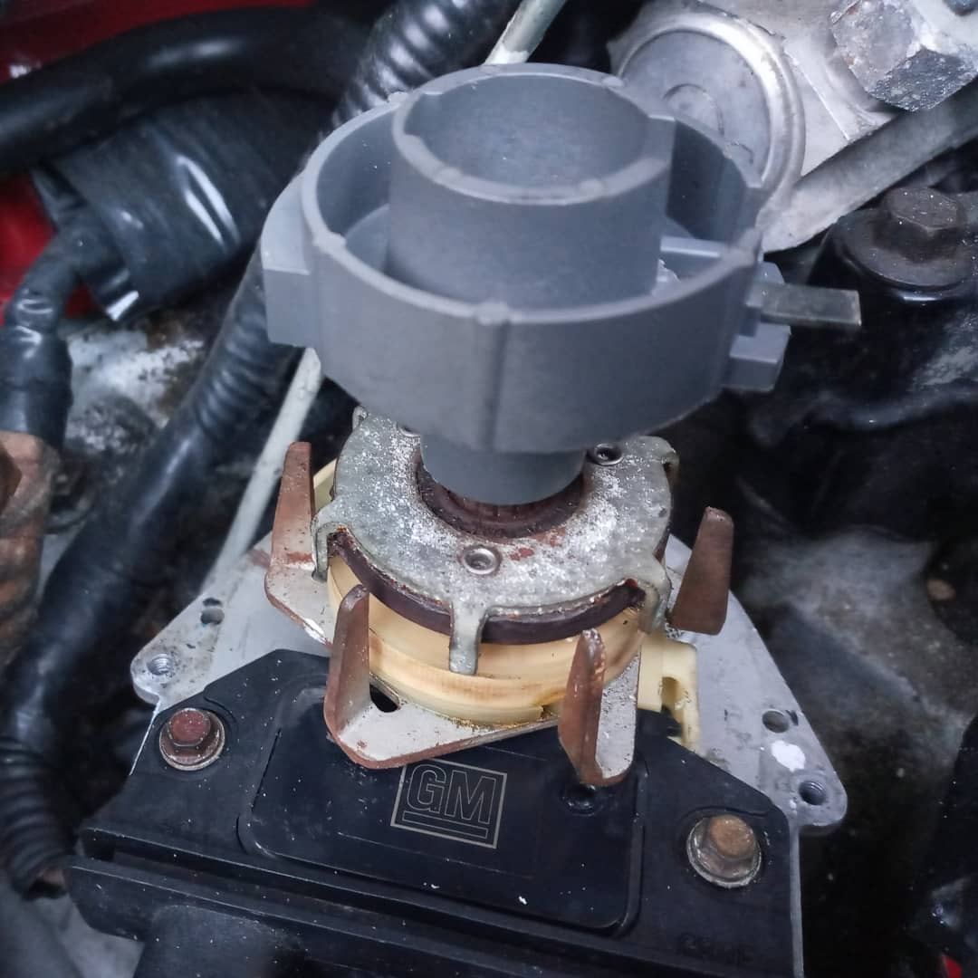

Well, I replaced the distributor and so far the problem has not come back! Thanks for the tip. Now the car fires up immediately, every time, with just a tap of the key. And it sounds better too! The snap crackle pop when I shift gears is so satisfying. Upon closer inspection of the old dizzy, I found metal shavings stuck to the magnet rotor of the dizzy shaft, so that can't have been good. The new distributor has a heavy cast metal magnet rotor and stator, rather than the old stamped metal factory one.
PatrickTRoof
MAR 16, 02:46 PM
Old:
 New:
