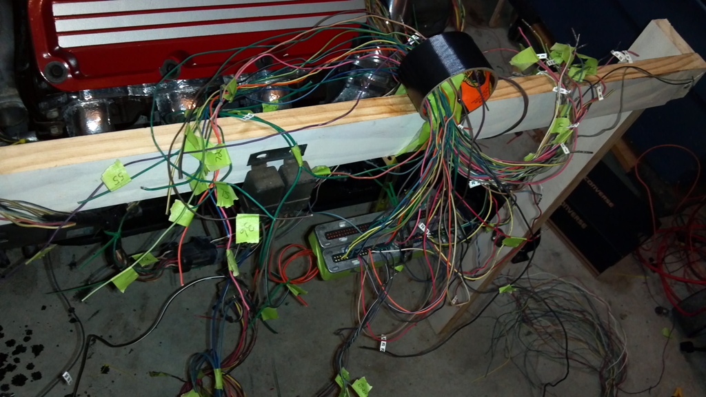

True, my last harness I pulled each wire out of the PCM connector, routed it for a clean look and in the end it was 100% custom, but in that case its still pull from C11, reroute, put back into C11, (cut/crimp or just fold). Its not difficult, just time consuming. You still only have to "figure out" the 15-20 wires that join the two harness together.
Rickady88GT
JAN 24, 07:37 AM
I relocated several plugs and rerouted the harness to clean it up. I also relocated the fuse relay box to the front spare tire area. I did not count the splices, but it was approximately A LOT. I am happy with the LS4. I love the sound most of all.
