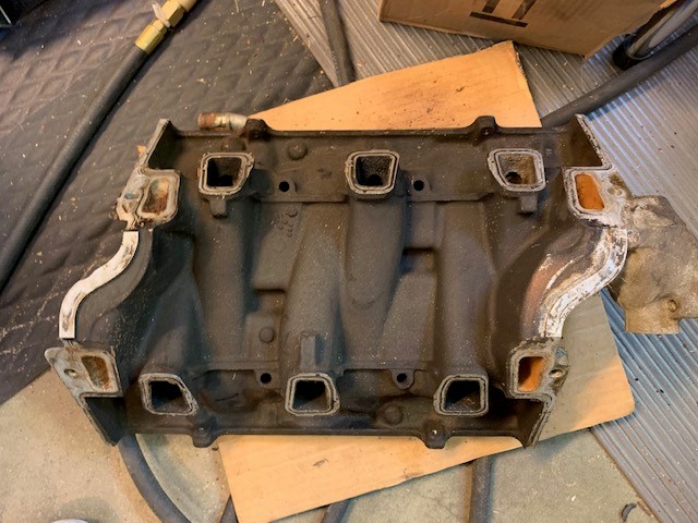

| quote | Originally posted by pmbrunelle:
After pre-washing the case, yes. That ain't no photoshop! |
This is actually one of my big plans for my workshop, a crappy old dishwasher is a pretty good parts washer.------------------ "I am not what you so glibly call to be a civilized man. I have broken with society for reasons which I alone am able to appreciate. I am therefore not subject to it's stupid laws, and I ask you to never allude to them in my presence again."

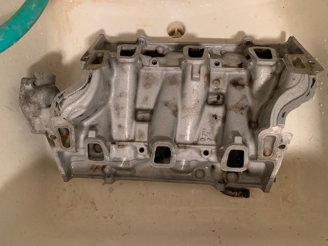

Here, I clean the transmission case:
| quote | Originally posted by ragoldsmith:
Did you...really put it in the dishwasher?? This is fantastic! |
I've put an engine block in the dishwasher...

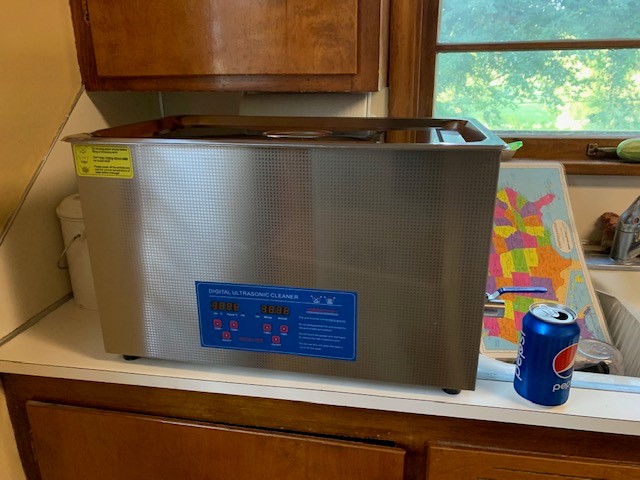

| quote | Originally posted by ericjon262:
And you can start it and walk away without spending hours scrubbing. With a dishwasher and the largest ultrasonic cleaner you can find, you'll never reinstall a filthy part again.[This message has been edited by Will (edited 01-14-2021).]

With aluminium, I would say that the usual high-pH soap works, but it can leave white corrosion on the surface, requiring extra cleanup if you're not fast at removing and drying the parts after washing.
There does exist aluminium-safe degreaser such as some variants of Simple Green, but it might make bubbles and not work in a dishwasher.
There does exist some anti-foaming stuff that kills bubbles; perhaps this could be used to make Simple Green or others work in a dishwasher. I know it works... when I was a kid, I used normal Sunlight dish detergent in the dishwasher (bubbles poured out everywhere), and my dad brought home this stuff from work that killed the bubbles.
