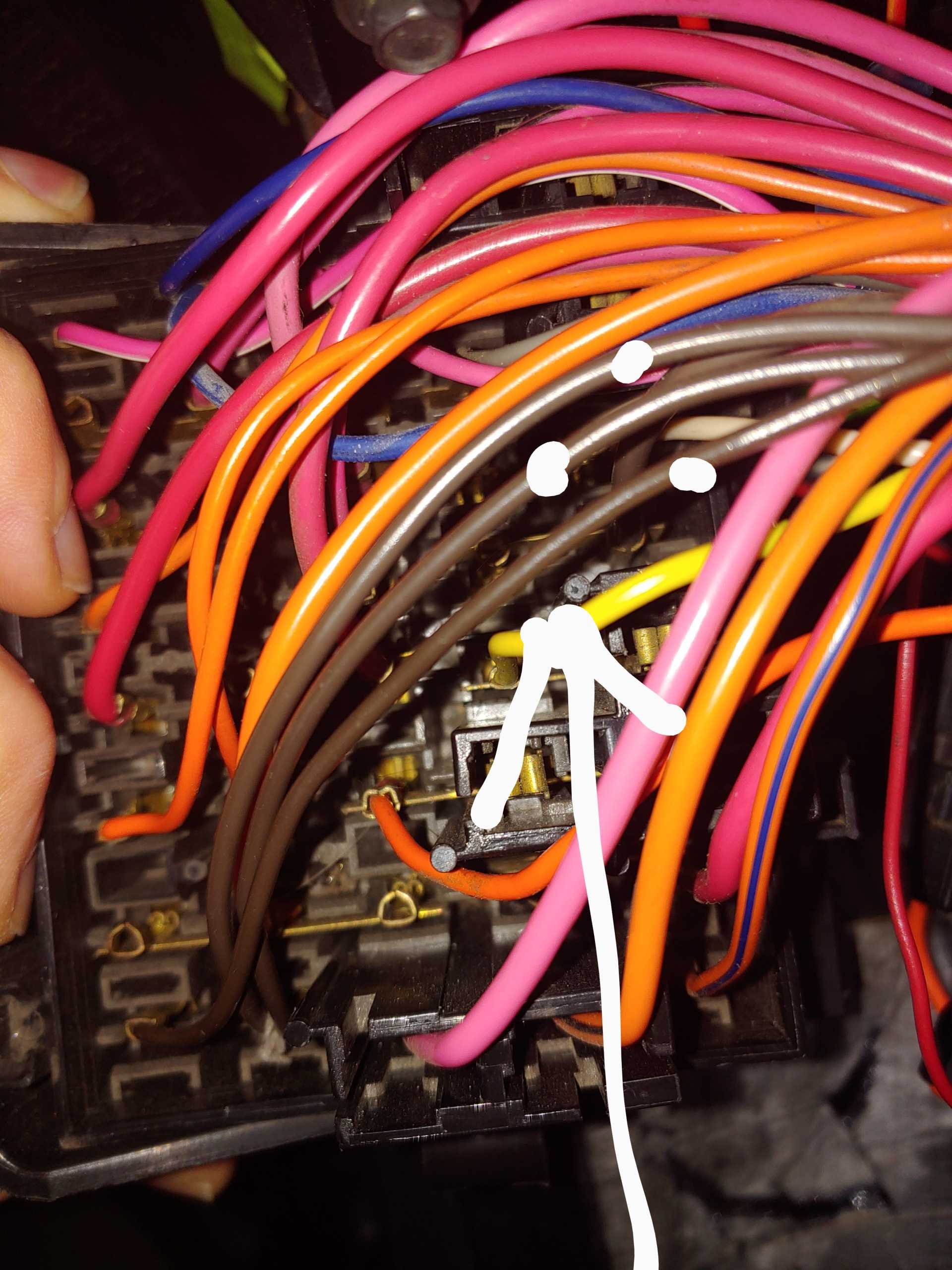

Also, here is a pic of the back side of the fuse box where I have marked the three branches of the brown wire.

Rexgirl JAN 09, 04:56 PM
Did you connect your iKey to one of these three brown wires? If so, you may have connected to the wrong wires as those may be the ones serving power to the HVAC system. There is fourth brown wire behind the three browns, seen in the center of your three white dots, and that may be the main power feed to the radio and wiper.
Your indicated brown wires could back feed power through the Fiero's ignition switch to the radio, which may account for why the factory switch needs to be operated to supply power to the radio.
