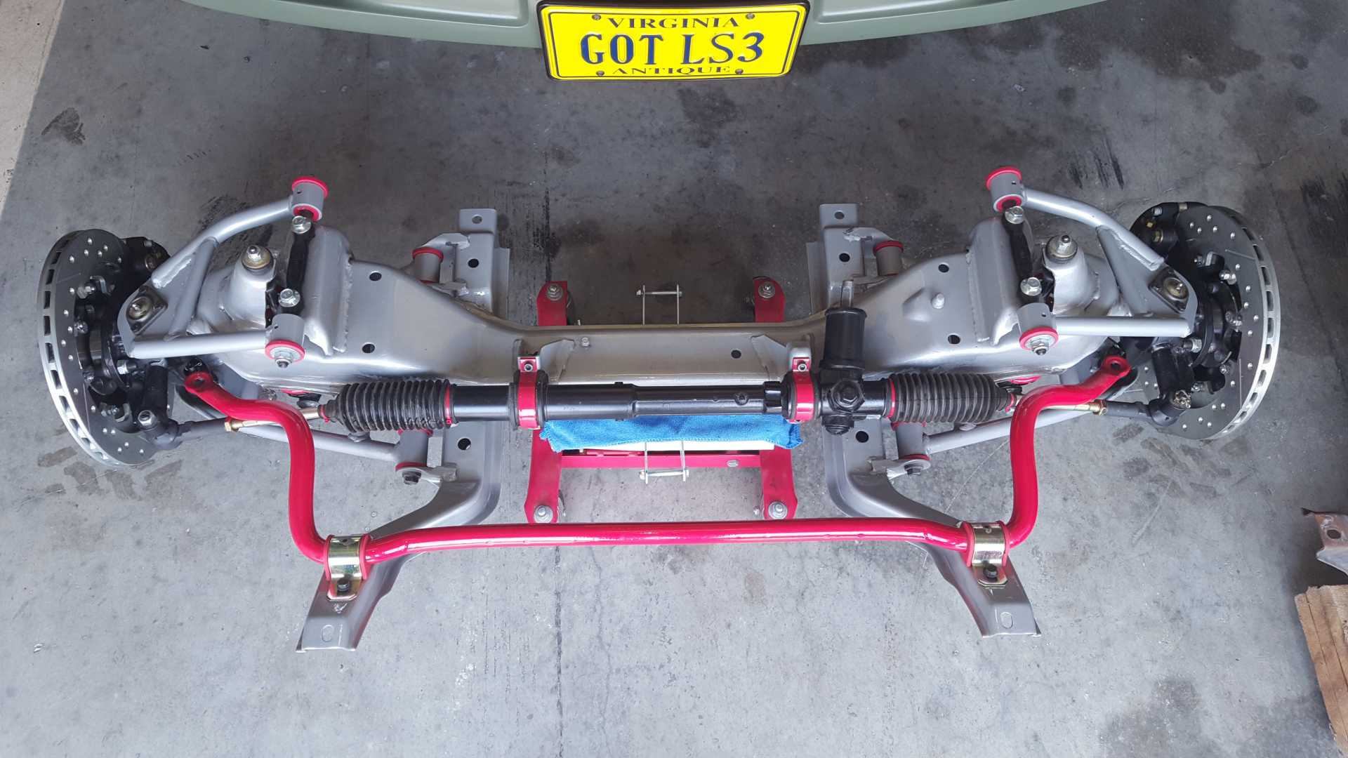

I have the same setup on my 88, the ball joints are the OEM 88 Fiero ball joints upper and lower.
I have a spare set of lower bushings and they have 2621 molded in the end, probably an Energy Suspension part number. I would call them and if its not theirs then Prothane. The upper bushings probably have a number also, the number on mine is on the end without the flange.

yep, Held / Arruat MS front end.
