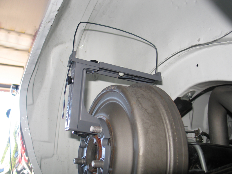

Something like this would be helpful....
Percy's Wheelrite....(You may be able to make your own- that is $66 on Amazon)

I have a set of XXR's. 17x9.5 rear and 17x8.5 front and will fit perfect. They are powdered coated Spanish Fly Gold. I also have the tires for it. Dunlop Direzzas 225/45/17 front and 245/45/17 rears.
This is how they fit. They are not black anymore.
