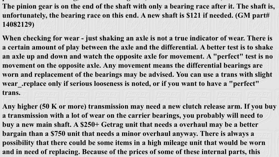

DEC 02, 04:33 PM
I found this text from I believe rodney dickmn. Does anyone know how much play in the other axle is too much play? I have this clunk noise but want to ensure it is from the diff bearings before I do all of this work
