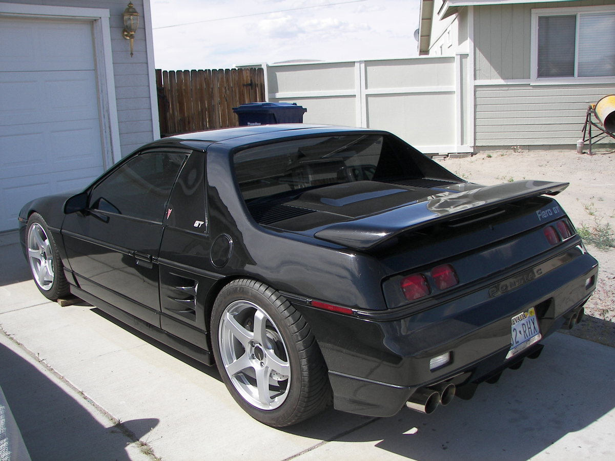

Johns 4.9, you have a nice looking car what year is it? What size are the rotors and wheels?
Thanks Joe
Johns 4.9 DEC 20, 12:20 PM
Hi Joe,
Thanks for the compliment on my 85 GT. Rotors are Chrysler 11.25 inches. Wheels are 7x17 front, 17x8 rear, tires are 225 45 up front and 255 45 in the rear.
