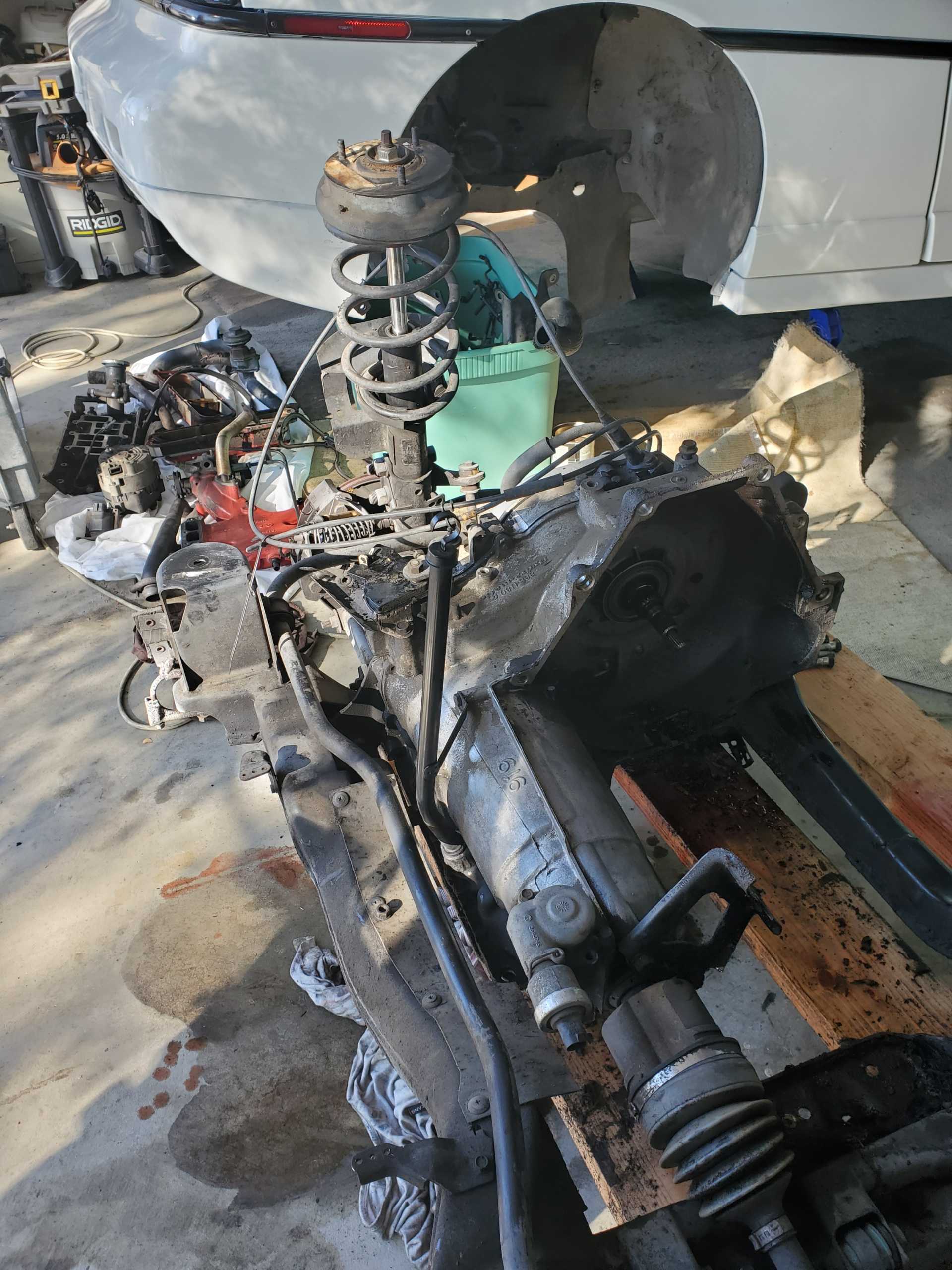

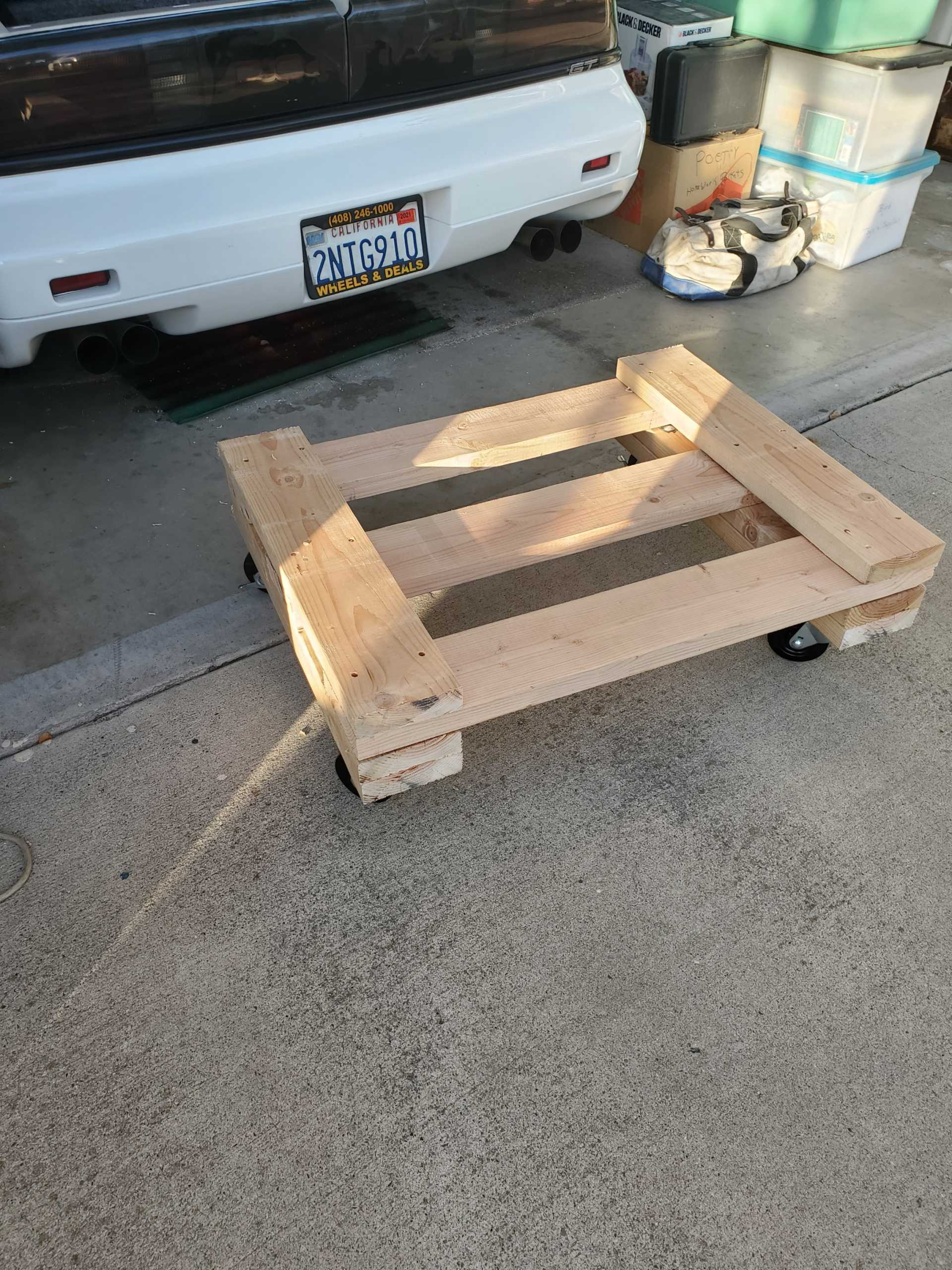

eti engineer
NOV 15, 06:12 PM
This is a cradle I built using information from the Toddster who posted in here. I have found this cradle and a cherry picker to be the best combination. Using this, I was able to pull the cradle intact and then with the aid of a cherry picker, separate the engine to put it on an engine stand and I left the transmission on the cradle I built. Works great!!! Thanks, Todd
eti engineer
NOV 15, 06:25 PM
picture of the tranny on the wooden cradle

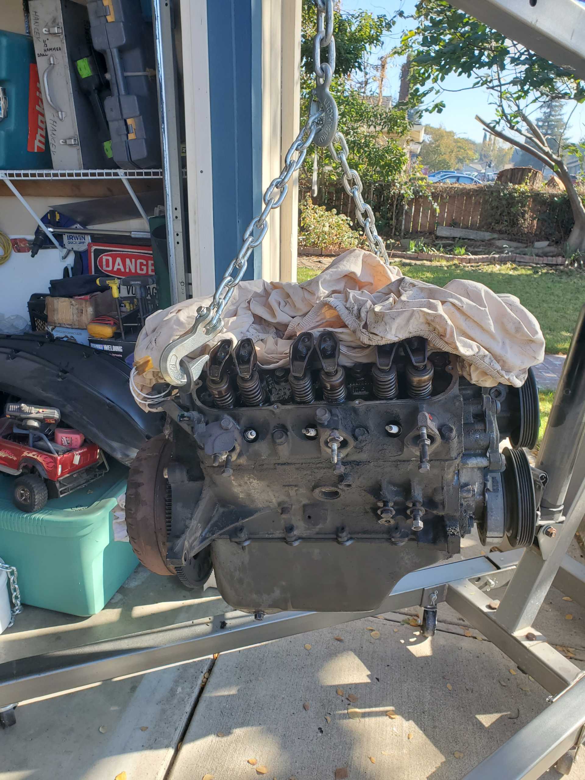

eti engineer
NOV 15, 06:27 PM
Engine on hoist, ready to put on the floor or on an engine stand to free up hoist for other things. This has worked very well for me, but to each his own.
