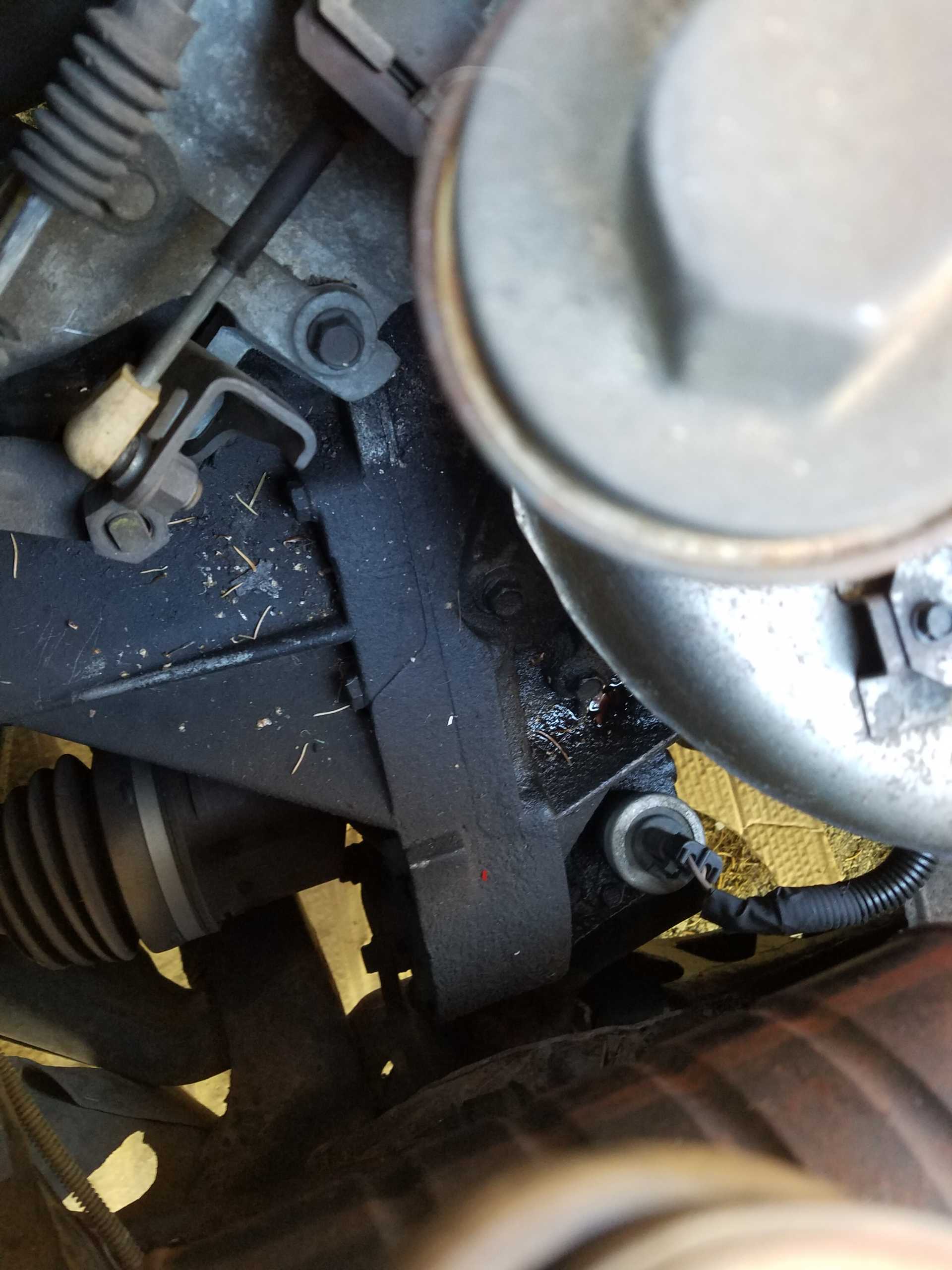

Alright here's a picture of where its pooling kinda underneath everything. Its definitely oil.

Without being there to look around more carefully... I'd guess it might be the distributor O-ring. A very common source of oil leaks on the 2.8 V6.

OCT 09, 05:47 PM
Would a leak like this cause power failures like described or is this more likely a different (and likely minor, I'd assume) issue altogether then (if the o-ring/leak is the case, that is)? Unless it's leaked so much oil to cause to problems.
OCT 09, 06:01 PM
| quote | Originally posted by CZSeventyFive:
Would a leak like this cause power failures like described...?
No.
CZSeventyFive
OCT 09, 06:15 PM
Figured, but thought I'd ask. Will have to try it to seal it up anyways.
OCT 09, 07:28 PM
Don't get a rubber O-ring. It'll just get hard and oil will leak by it again. Get This or one similar locally.
