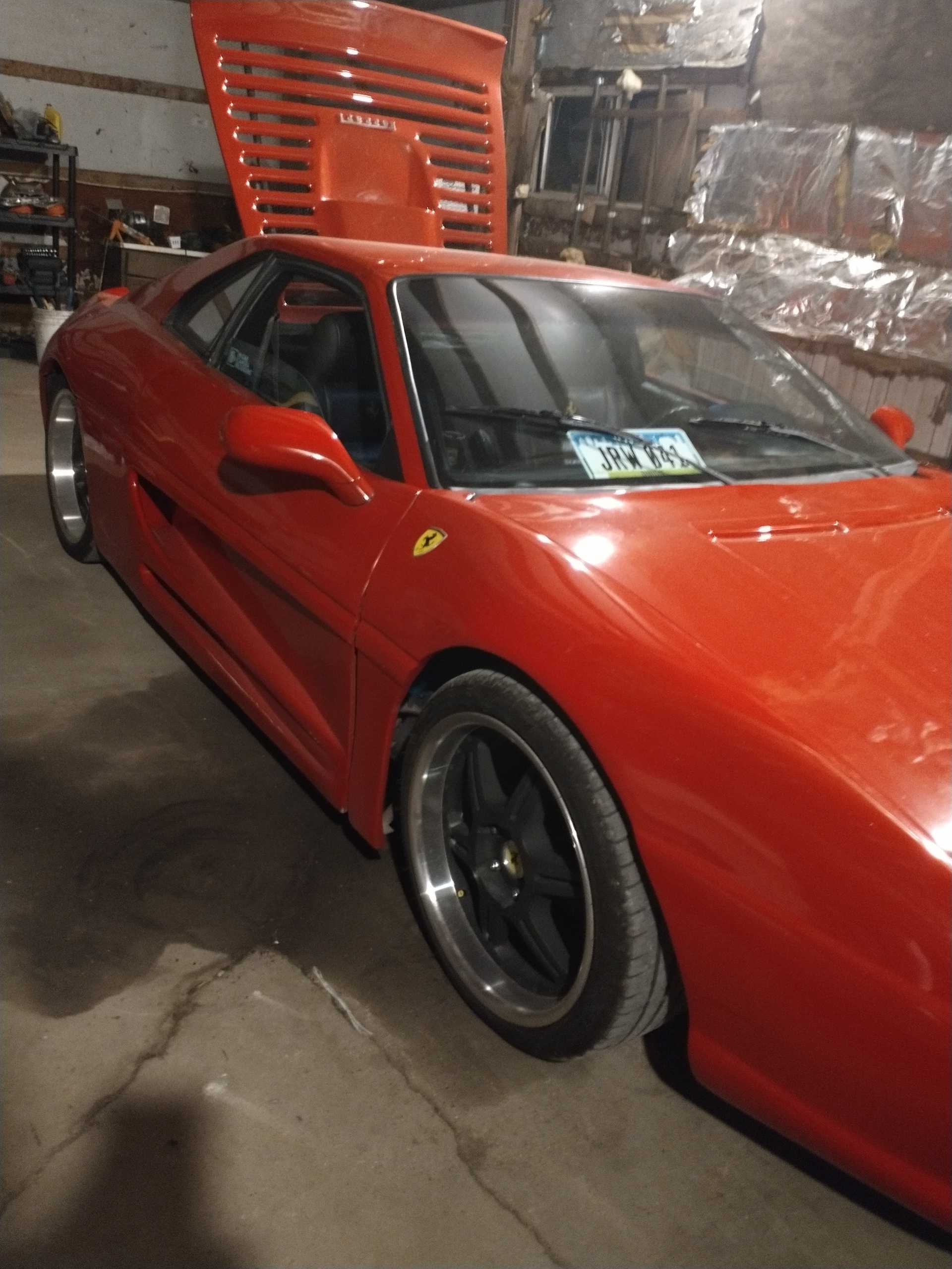

I consistently get about 8.5 lbs of boost from these superchargers on a 2.8
The entire unit sits 1/2 inch lower than the original fuel injection
My car is a Ferrari F355 replica. It has additional clearence under the hood
The strut tower must be modified and a smaller coil over shock upgrade to make the room for the modifications to the strut tower (already done)
Basically it needs trimmed back a few inches on the forward inside corner Rewelded to close off the tower from the engine compartment and some extra bracing to ensure structural integrity of the tower.
Compared to the four link and full tubs I put into my SS Nova it will be a easy modification
As for the fuel injection I have mounted the holley sniper unit as a side draft and located it in roughly the same place as the original throttle body to make the original throttle linkage easy to hook up. The 90degree upper manifold to supercharger is a easy build With some good skills at cutting, bending and welding the hood clearence is not a problem..
With no emmisions A free flowing exhaust A matching camshaft and the new holley sniper two bbl EFI I can pull about a additional 100 hp from a 2.8
Once fitted and functional The 2.8 comes out and a iron head 3.4 will go in its place
In the rear wheel drive version I've pulled a peak hp of 276 and peak tq of 262 ft lbs. From the 3.6 with 8 lbs of boost.
Of course there are lots of details I'm leaving out
butt hey
I'm a professional engine builder
You can't expect me to give out my exact blueprint.
All my personal vehicles get a 50shot nitrous set up
Because superchargers lose some power in the heating of the air fuel charge the 50 hp kit reclaims another 10 to 15% more total power over the 50 because it acts like a super intercooler and dropped the air/fuel temperature significantly when the system is engaged.
I do not have a exact figure for the n2o as I don't dyno nitrous systems
I'm starting this build sometime in the next four weeks as I'm just finishing up a turbo charged supra and then I have a BB chevy to do for a customer.
Gotta pay the bills before I play on my toys.
I will video document the entire build and post links for those that are interested.
