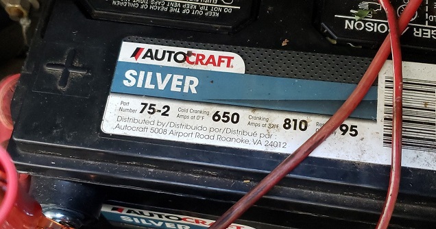

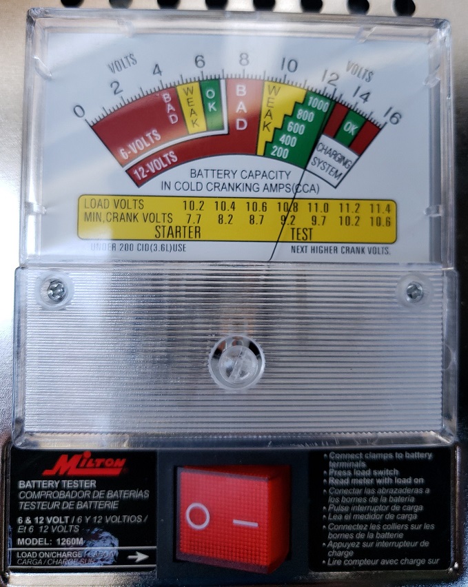

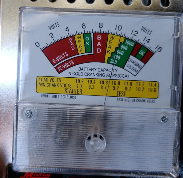

I'll presume my test results show that the battery is OK?

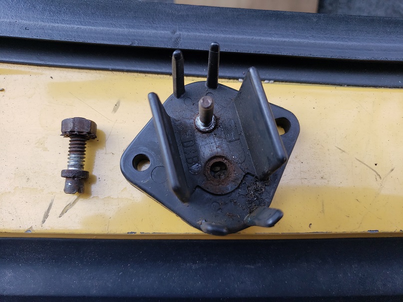

But in disconnecting the wires from the power distribution block, it broke. So now I have a new one on order from e-bay. Here's the old broken one:
I've never used a battery load tester... but I thought all your previously posted readings were kind of low.
| quote | Originally posted by V8 Formula:
Edited to add: Voltage is down to 12.48 after sitting for an hour and 15 minutes...
Edited to add: Voltage is down to 12.46 after sitting for five hours...
Edited to add: Voltage is down to 12.34 after sitting for 27 hours...
Edited to add: Voltage is at 12.33 after 50 hours...
V8 Formula
OCT 05, 06:31 PM
Patrick- I haven't either but I did watch a couple videos where they show what a dead battery *might* do under load- I saw one pull all the way down to 3-4 volts. Mine only goes down to around to 10.5 under load but that seems low enough to possibly be one bad cell. Hoping Ogre will chime in when he gets a chance.

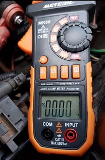

I wired things up and did some amp testing. I'm basically just trying to get a feel for how this amp meter works. I put the clamp around each power distribution wire near the battery and got a really low reading from each, close to zero but the same as with no wire in it. With everything turned off (but the ecm still plugged in) I clamped around the main red wire from the battery that feeds the power distribution block and got a reading that showed 00.01 A. Basically the same as with no wire in it.
Then I opened the driver's door and it showed 2.01 A
I turned on the headlights with the door open and it read 10.68 (I have LED headlights)
I turned off the headlights but left on the parking lights and had the drivers door open and got 08.71 A
Then with the door shut and the parking lights on I got 06.46 A
I turned everything off again and the reading went back to around 00.01 A
Lots of data and I have no idea what to do with it.
