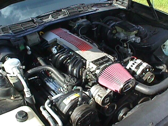

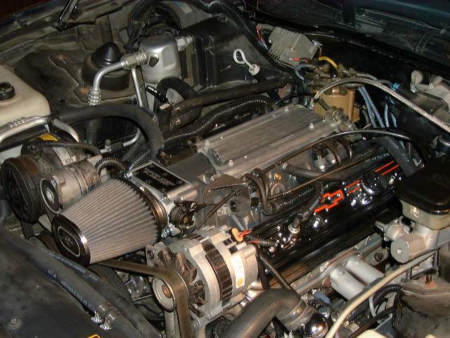

Hopefully you hit on the issue. A number of peolple threw out some good advice, but no one actually asked you what the issue was. You mentioned driveability, but that could mean different things to different people.
Anyway, it's been some years, but I had a built 350 that initially ran a port/polished TPI with original, then siamesed runners. Ported lower intake and Twisted Wedge heads. I was using an Accell DFI. Eventually switched to an LT1 intake (yes, I did the custom conversion) with LT4 hot cam. Never had issues with vacuum leaks or anything like that. Miss that car...
Curious if you solved your issue.
