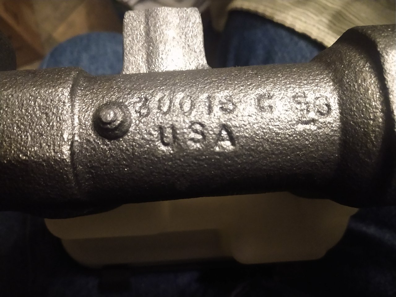

Just a heads up . After all the discussion I decided to play it safe and just replace the master cylinder with a stock part. I went with a new AC Delco unit and I purchased it from Summit Racing Equipment, a reputable dealer, so I'd get the real Delco part and not the counterfeits that are sold on eBay. I paid a premium price $130 shipped but when it comes to brakes whats your life worth?. The best part is that this master cylinder is Made in the USA and its stamped right on the bottom of the unit. If you decide to buy this master cylinder it is sturdy cast iron not aluminum. Installation was a 30 minute job. Pedal is no longer spongy but I will again bleed the calipers to insure best braking action..
 [This message has been edited by Dennis LaGrua (edited 09-26-2020).]
