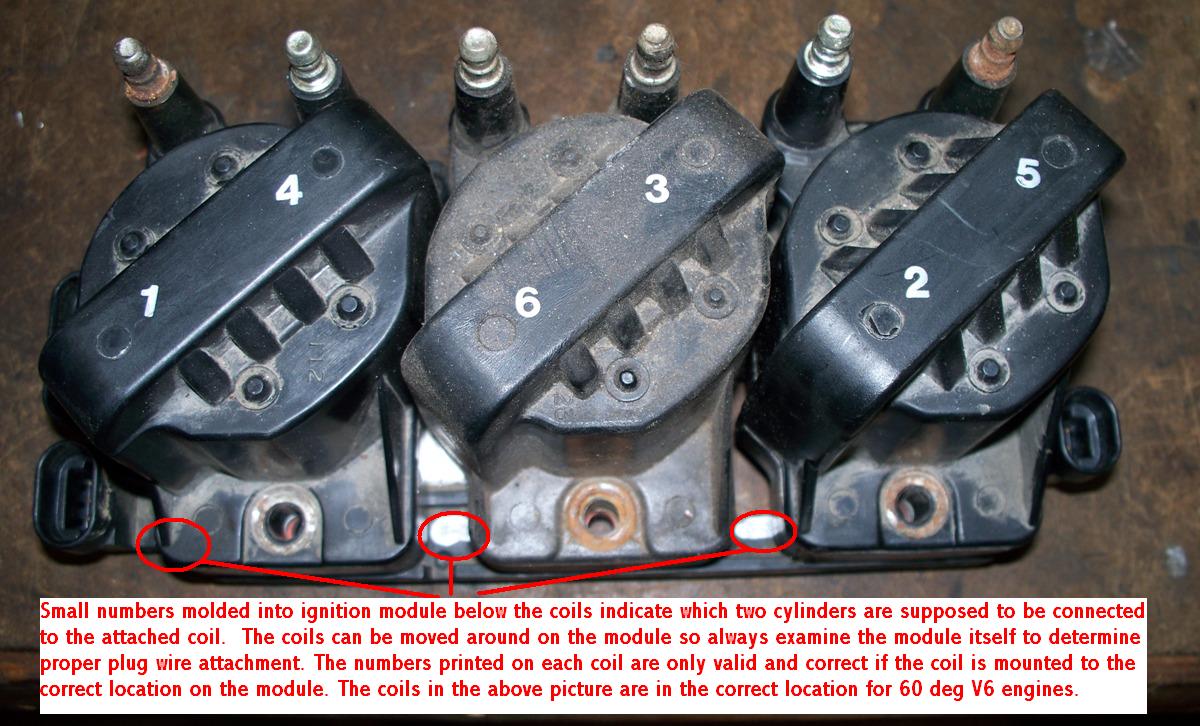

Patrick SEP 14, 10:28 PM
COILPACK INFO (from Here)
2.8L, 3.1L, 3.4L SFI, 3.4 DOHC, 3100 V6 & 3400 V6 coil pack:

OK, I got a chance to watch the video. That's not a lifter, so ignore my previous post. As mentioned above, that sounds like backfiring thru the intake. Chances are, the spark plug wires got mixed up.

Well, It would be nice if the two pictures of the coil pack numbers agreed with each other, but no........there is still a problem.
Blacktree SEP 15, 12:58 PM
They do agree with each other. I swapped the 1 and 4 on the one coil, to make the spark plug wires nice and neat. With a waste spark system, you can do that.
