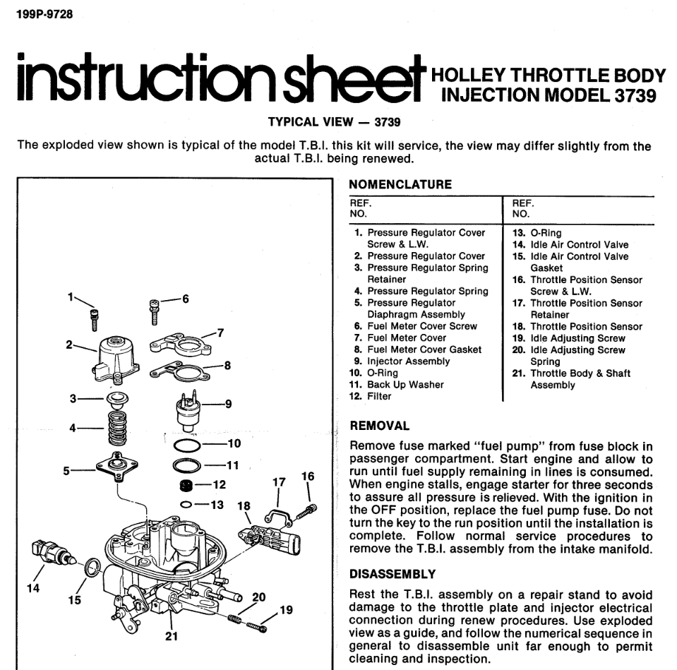

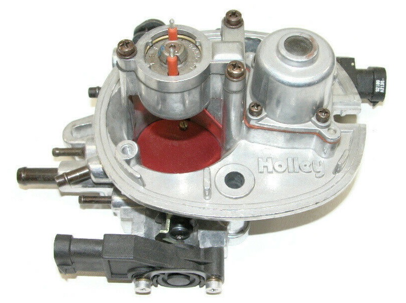

Holley 3739 is the family name for the Holley 300 series replacement TBI's, like the Fiero's 500-1

fierowannabe - Sorry if I didn't explain things correctly but I'm running a 3739 TBI on a matching Holley intake so there was no distributor to change and I'm still running stock.
RWDPLZ - Yes that's exactly it.[This message has been edited by snyderman (edited 09-09-2020).]
