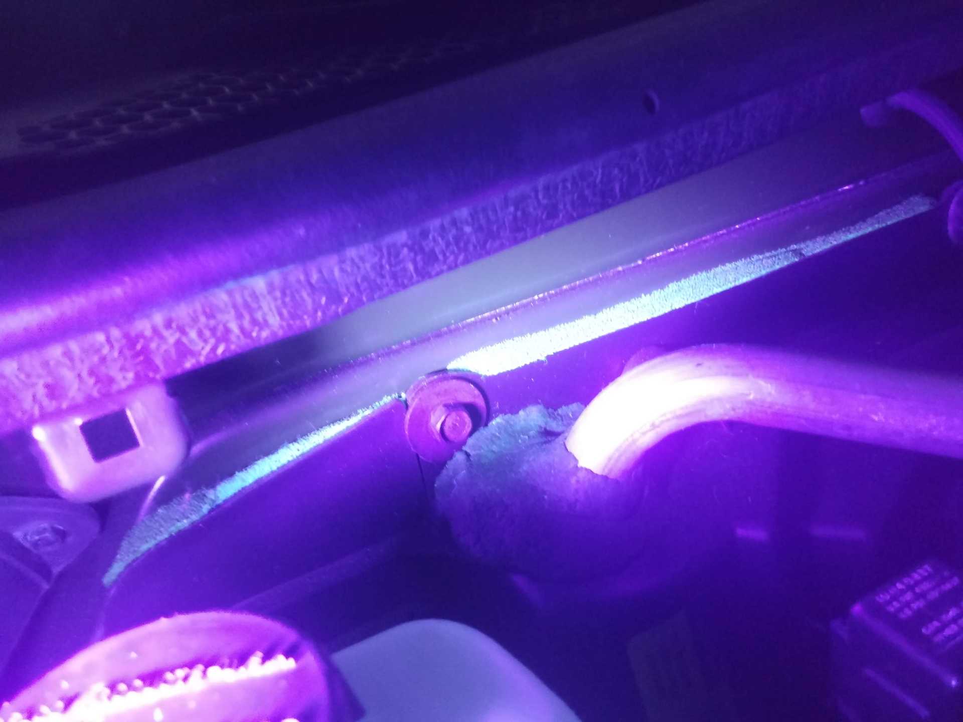

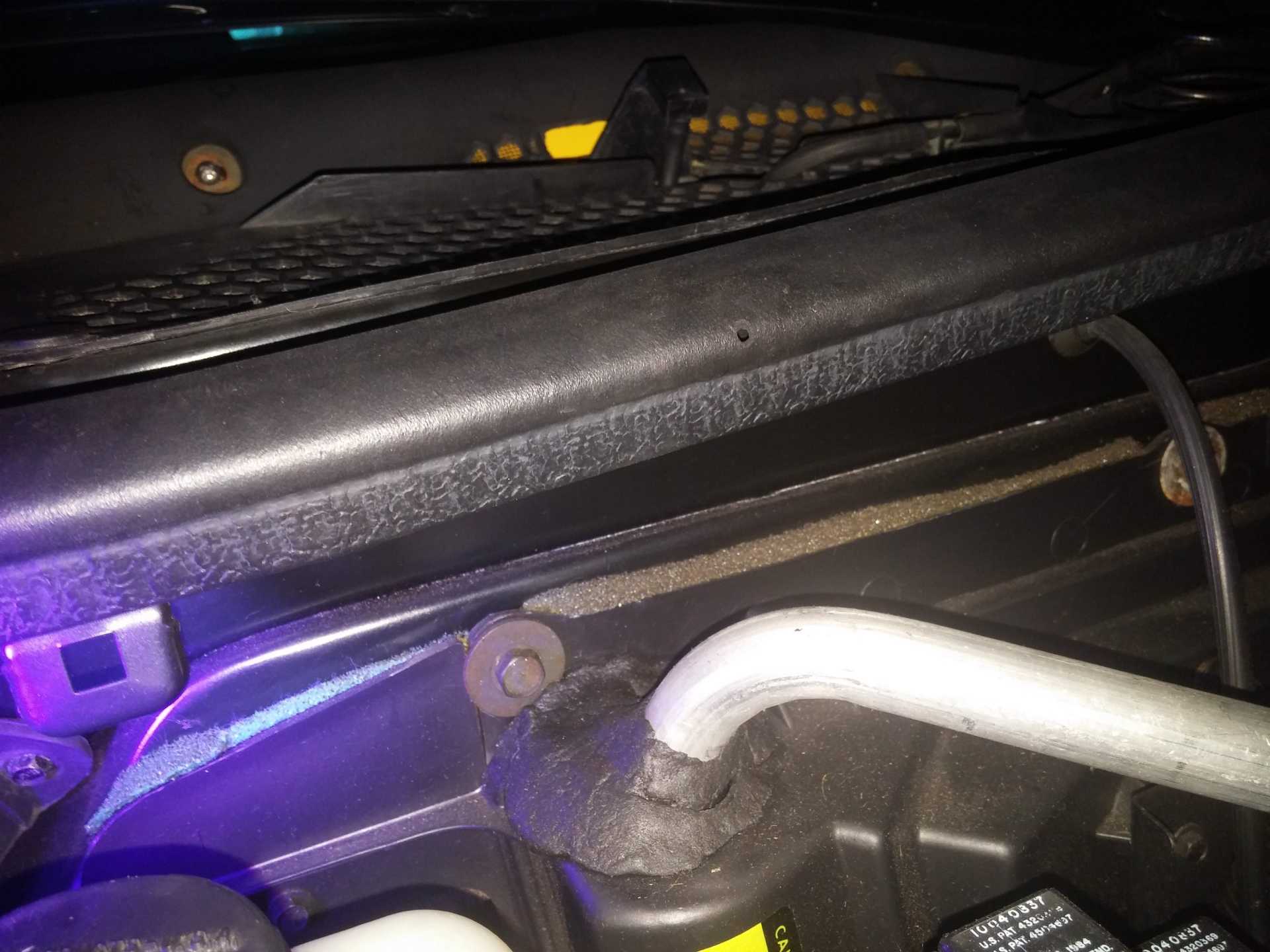

I did my extended drive with the dye in the system and now finally got the car up in the air to look. The dye is yellow, but very faint. It was one of those one-shot deals. I am afraid there was too little dye and it got diluted making any leaks quite faint. Anyway the only real place I saw what I think it something is at the evaporator.
Here is a shot of the evaporator without UV light
Here is with the UV light. All the open cell foam seal where the evaporator mounts has a faint yellow look. I am not sure you can see it though.
That evaporator looks like a bugger to get out. Before I go digging into that I thought I might put more dye and freon in. Maybe it will better confirm where the leak is.
Ideas anyone?
