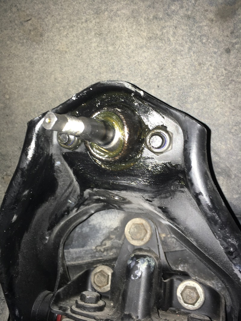

I am pretty much at a loss, but I decided to check my (new) front upper ball joints as a friend mentioned that they are directional and I don't remember paying as much attention as I should have when I insstalled them a while back.
I got ACDelco 43D0026A ball joints of Amazon, but the same ones on rockauto refer to "additional camber adjustment". When I took the boot off, I noticed that the ball joint has a deep "groove" on one side. Should it look like this? Are they in there backwards?
 [This message has been edited by Threedog (edited 08-11-2020).]
Rickady88GT
AUG 11, 10:52 PM
| quote | Originally posted by Threedog:
Update, alignment did not fix it.
Sorry, I don't know if they are or can be installed wrong, left for right. But if the alignment shop got it in spec, that could not be your problem. The ball stud should be able to swivel enough to allow the A arm to travel its full range of motion without binding. For example if the ball joints are directional, they might have more travel towards the wheel side of the A arm. This will allow for suspension droop without binding. BTW, that looks like a clean job you've done.------------------ [IMG][/IMG]
