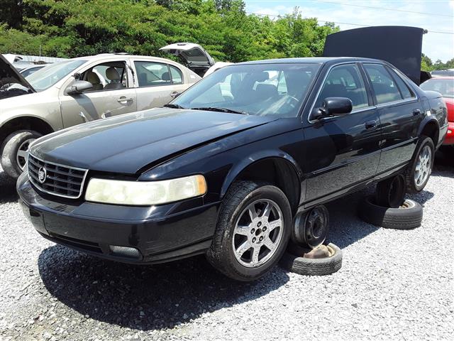

Occasionally on the Cadillac Forum someone asks about using the LS4 in place of the problem years of Northstar. It's pretty annoying to read the same replies from the same person who doesn't agree with the proposition. Today my favorite yard placed a gorgeous black 03 STS. No damage. You know it's an engine failure and they just threw the car away for a few hundred dollars.

The repair makes the engine bullet proof, but is labor-intensive. With the depreciation of luxury cars, particularly Cadillacs, the economics of repairing frequently don't work out.

What is the cost of a Northstar head repair job? LS4s are cheap right now and bulletproof on their own. The upside hp is easier to get to. My '09 I pulled with trans, ecu, gas pedal and harness was $500. It doesn't need $600 in head threading repair to get it to just being normal again (before labor). It needs a cam and lifters and will be better than it was. The Caddie is a throw-away because of the several thousand dollar repair to the Northstar, and you still have less power with no aftermarket support. The N* sound is very nice but I'm a little underwhelmed at the power when I drive my DTS. A 400ish LS in there would be fairly easy and have room for a turbo for 500.
This car made me a little sad. It's pretty nice. For less money in repairs it could walk the Northstar.
