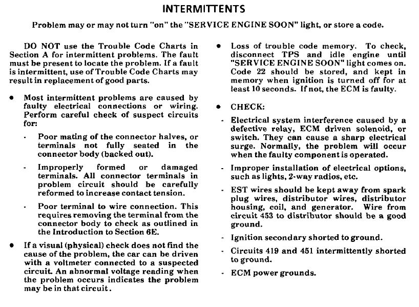

Intermittents and ECM test...

No Injector output is often a "dead" ECM.
Try tapping the ECM w/ fingers trying to start after dying. Sometime may help but ECM is "dead" if that does help.
Common fail mode is parts inside of ECM w/ iffy solder joints, "bad" "transistors," and more that work when completely cold or stop working parked overnight. ECM/PCM parts can heat to Full Operating Temp in Seconds to a few Minutes regardless of weather but Cabin Temp can affect when Iffy ECM works or dies. (Parked in sun even on cool days can make Cabin Temp climb above 120°F.)
Most if not all EFI setups have "12v" w/ Key On and ECM/PCM Turns On Injection by Turning On a Driver "Transistor" on the Ground side on the Injection. In your case that the Blue wire from injector. All it takes to have problems is a very small crack in a solder joint to that "Transistor."
("Transistor" because includes MOSFET and others but exact type of Driver part is unimportant here.)
Best is Need a Noid light to test the "signal" to the injector.
option is back probe the injector plug w/ + probe to V-meter - probe to engine... Leave Injector plugged in. key on, engine not running after it Dies.. Does Red wire have "12v?" Yes, does Blue have "12v" too? Yes then Injector Coil likely good. Keep meter there and try starting the car. Meter should "go nuts" and display odd volts because ECM will "short out" the blue wire every time it turns on the injector "transistor."
