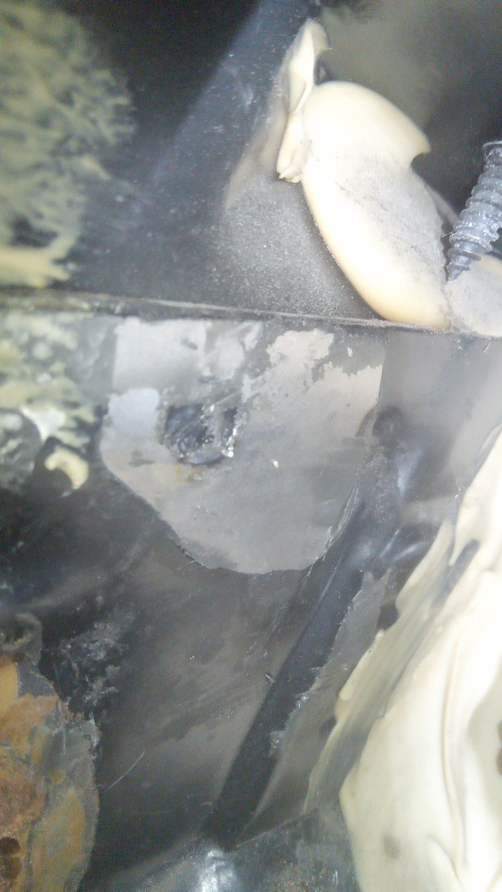

Doggy doggy what now...the black goop covered over patches of beautiful clean metal that looked like they have never been painted from the factory!

PK SEP 22, 10:57 AM
Originally posted by Mike in Sydney:
If the frame-rails are O.K., I'd say there was a once a leak in the gasket around the boot. An '86 SE that I had this problem and it used to collect water when I left it parked in the weather or after I washed it.
Thanks Mike....that is what happened, indeed it is still a leak. The entire boot is dry after washing other than that exact spot.
No visible boot seal damage but I will have to find someone small enough to shove in the boot with a candle to find the leak. :0)
Mike in Sydney SEP 22, 08:54 PM
If your weatherstrip around the trunk is broken or torn you might try to glue it back together with some 3M™ Black Super Weatherstrip Adhesive taking care not to glue the cavity shut. Once repaired, you could use a strip of flat neoprene foam weatherstripping (buy it at a caravan shop) on top of the old weatherstrip or on the boot lid to make sure there's a good, tight seal between the boot lid and the luggage compartment. Alternatively, you could order a replacement trunk seal from the Fiero Store. (Pricey but worth the money.) I have new seals on both of my GT's and the compartment stays absolutely dry in the rain and when I wash the cars.
