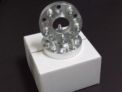

quote | Originally posted by bootdsc:
Any good reason to not use wheel spacers with the Fiero? I really like the stock wheels and I don't want to replace them just to get the offset I need
There are some members here who think using wheel spacers/adapters rates right up there with cutting a coil off a spring... they don't feel it's right. IMO, it depends to what degree in both situations it's being done.
I've run these 1" hubcentric spacers on the back (just the back) of my Fiero(s) for the last 14 years with absolutely no issues They bring my Sunfire wheels (with the wrong offset) out to the edge of the fenders (instead of being tucked in too far).
Keep in mind that using spacers to push wheels out beyond where the factory intended the wheels to sit will put greater stress on the wheel bearings.[This message has been edited by Patrick (edited 06-17-2020).]
I hadn't thought about added stress on the bearings but I did figure I'd need to adjust the camber. I just like the stock wheels so much I can't part with them just for a wider stance. 1" out front and back and I wouldn't even need to add fender flares, do you have a source for the spacers you used?
JUN 18, 05:38 PM
eBay, where else?
Just make sure the spacers are indeed hubcentric.
