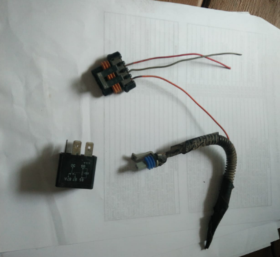

i pulled this relay today in the junkyard cuz someone said that the relays marked ABS are more reliable for the fuel pump than the Fiero relays.
i have read recently (GM Tuners - Ryanz site) that the fuel pump wiring is not sufficient for a 3800SC even a stock one, and he shortens up the wiring to decrease the IR drop, so i know i have to modify my fuel pump wiring. You are recommending another relay wired in parallel so as to decrease the IR drop and build reliability if one relay fails.
Whatza good fuel pump for a stock setup (minus the second O2 sensor)? that is reliable, easy to find and sufficient pressure and volume?
So you're saying that some 3800z oil pressure senders are wired up differently than others in that they have two wires?
i also took a look at the 3800 alternator while i was in the junkyard i used an S10 alternator cuz it was easy to build a bracket for it. The wiring is different tho, so it made me wonder how to wire it. My 2002GTP was wired with a red and an orange, but this Buick had a red, an orange and a tan wire. i might add a tan wire just in case. Don't wanna build my harness and forget wires. ;-)
