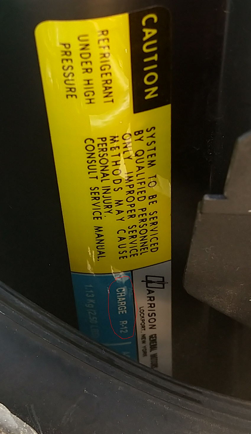

Sledgehammer's question seemes similar to mine, so I'm going to post here. When I bought my 1988 4cyl Fiero the previous owner, who'd had it for about 18 months, said that the A/C didn't work. He gave no specifics beyond that. Here's what I've learned: 1) When turned on, the system does not cool the interior of the car. So, it wasn't like the previous owner didn't know where the A/C on/off switch was or anything. I was kind of hoping for that, but I guess I was a little optimistic. 2) The compressor appears to kick in and its clutch appears to function. When I turn on/off the A/C I can hear the clutch kick in. Also, my rev's change indicating that the clutch is putting a load on the system. 3) The system appears to pressurize at least a little. It was probably wrong, but I let a little air/gas out through the schrader valve at the top of the accumulator and I got an encouraging hiss.
Here's what I don't know: 1) Is this system set up for R12? How can I be sure? The accumulator has, what I've been led to believe are R12 type fittings (Shrader valves) and there's a sticker with "R-12" on it:
2) If the system is set up for R-12, what else do I need to know in order to make a decision regarding topping off with R12 or going to R134a? After 32 years is it possible that the system will still work with just a charge of R-12? I know for a fact that the car spent many years in Arizona, so it is very likely it's A/C got a regular workout.

1. Yes, that system is still set up for R-12, the ports don't have the conversion fittings and no sign of a conversion sticker. 2. You need to determine if the system has any charge. You can press a screwdriver tip on one of the schrader valves briefly and see if anything comes out, if there is pressure, you'll need a gauge set to determine the state of charge.

1. Yes, that system is still set up for R-12, the ports don't have the conversion fittings and no sign of a conversion sticker. 2. You need to determine if the system has any charge. You can press a screwdriver tip on one of the schrader valves briefly and see if anything comes out, if there is pressure, you'll need a gauge set to determine the state of charge. |
So, the schrader valve already gives a hiss when pressed, therefore I'll be using a gauge to determine how much charge is in there and/or removing any R-12 that is present, right?
