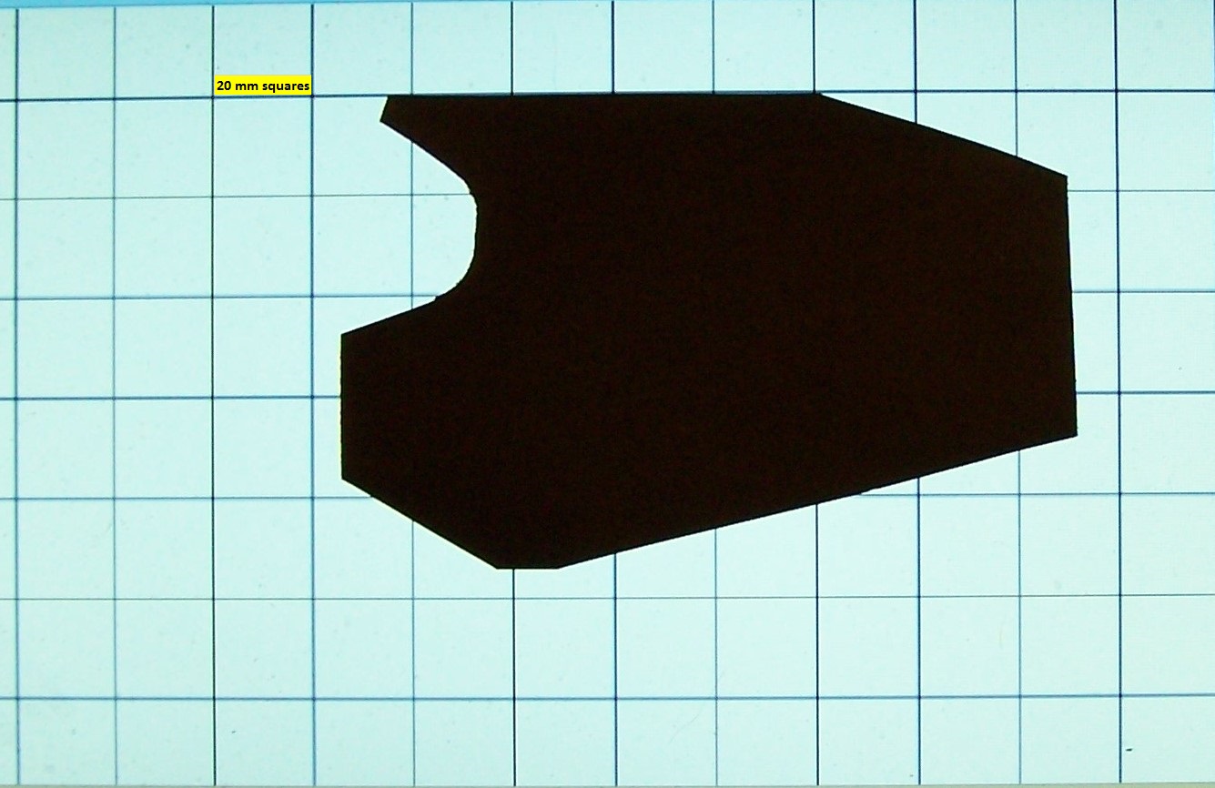

Some people have asked for a pattern....Can't go out and buy graph paper at the moment, so I was able to bring some up on my laptop, then take a pic....the grid squares are 20 mm each.....Not sure how to adjust the pic/printing size so they are right on a printed sheet.......(Anyone know how?)

Thanks for putting out the template!! I'm saving it into my Fiero 'to do' folder, so I don't have to find it again later
