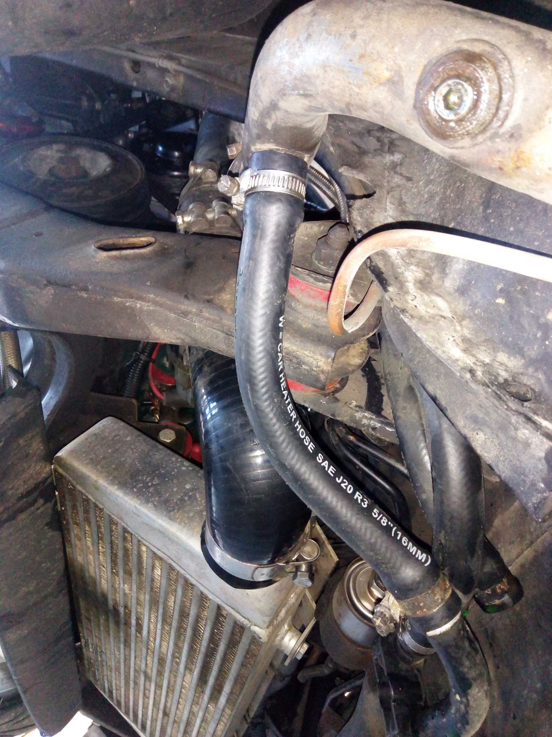

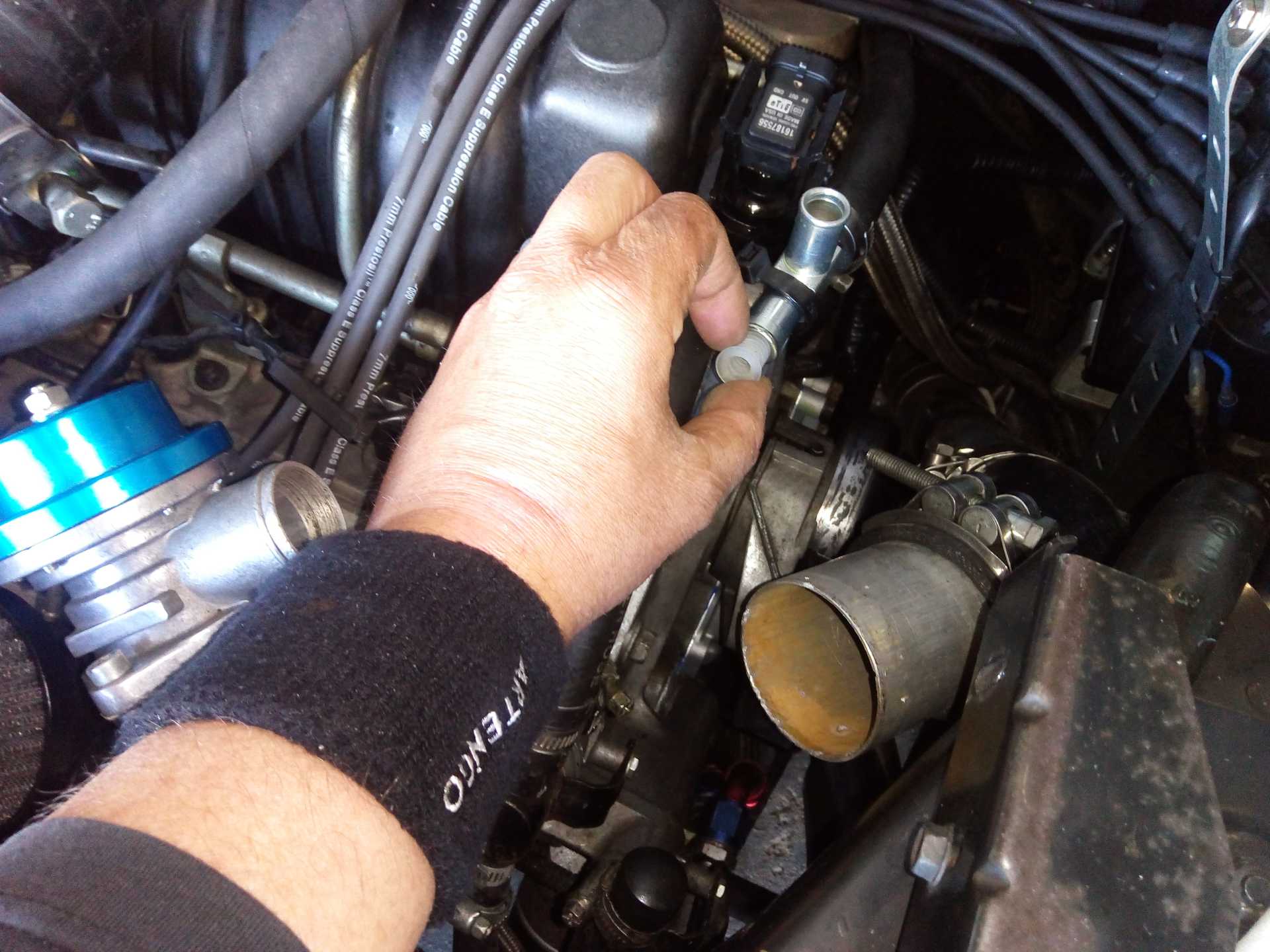

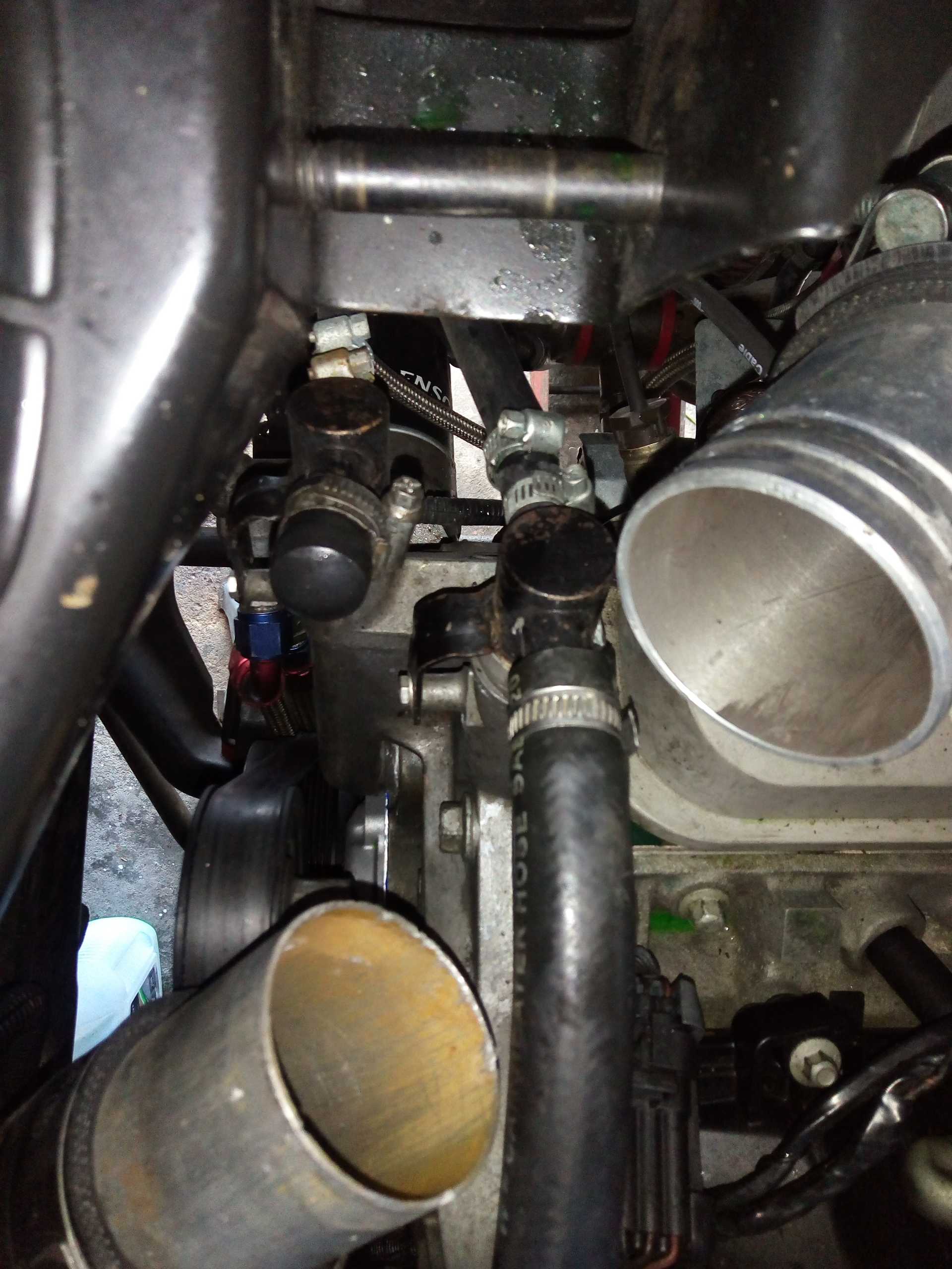

OK, 3800 heater return blocked off (still have my turbo water feed, but it's small diameter tube):
Put back the heater return pipe as original:

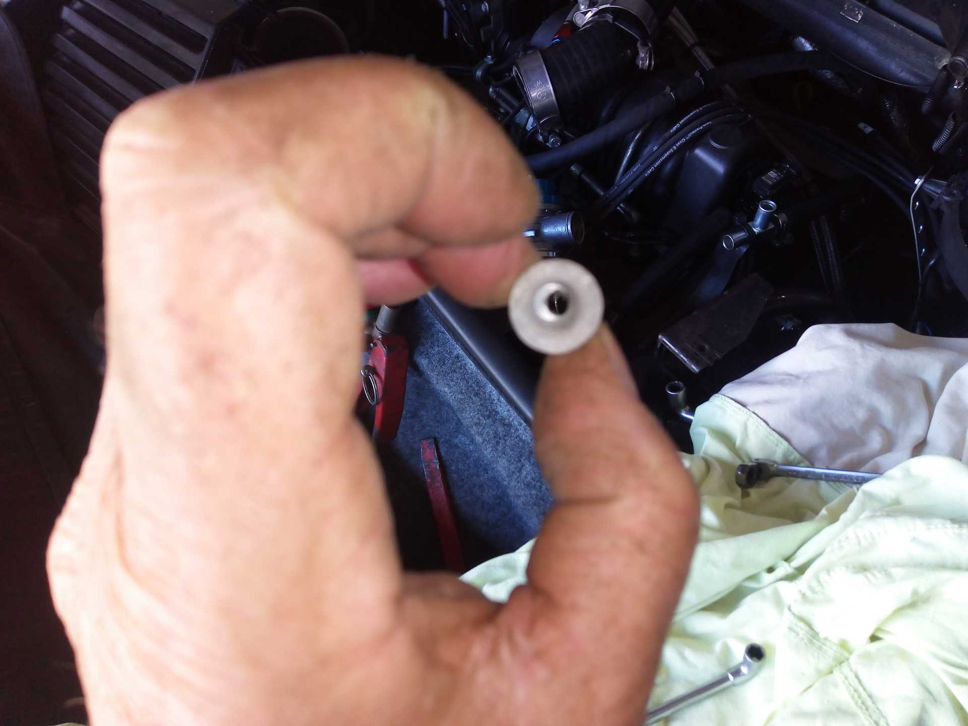

And made a 5mm restrictor to go in the heater feed hose. (I use a tee at this point to fill my coolant system as it's the highest point):
