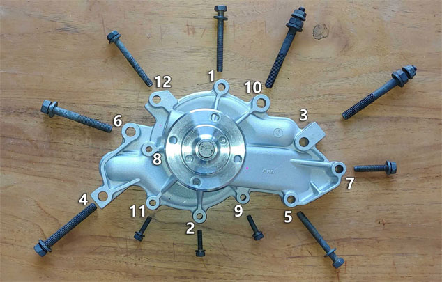

I don't have a garage so I did the water pump at the side of the road. I'm guessing replacing gaskets isn't something I could do at the side of the road...

quote | Originally posted by Dennis LaGrua:
(or maybe unsealed water pump bolts)
Which bolts should be sealed? Only bolt #4, right?
