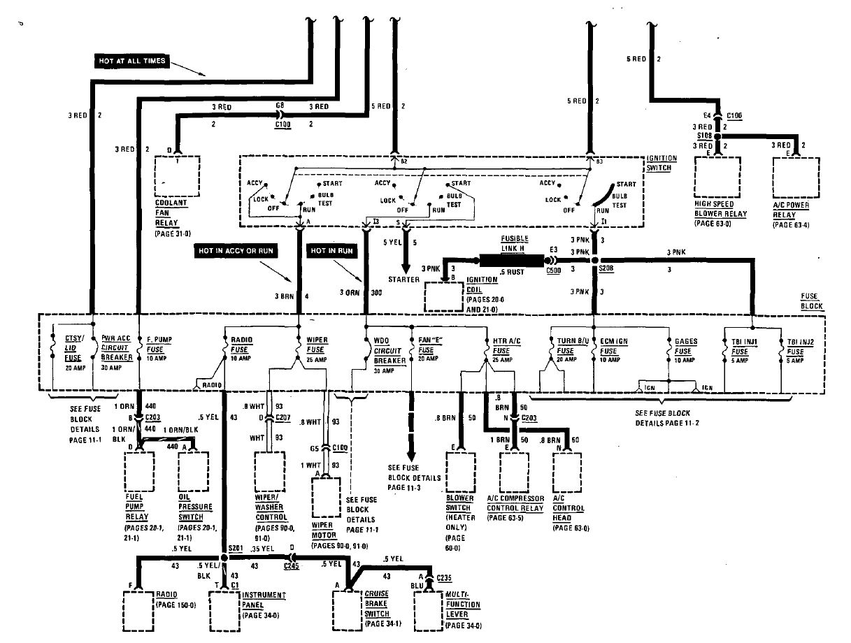

Next time when fuel pump is not priming, you'll need your voltmeter to figure out if ECM is powering relay and take it from there until you find where the power stops.
You may have to do some "wiggle wire" tests to find an internal break in a wire.

for a week it worked perfectly. (Normally). Now no more" priming" Again, BUT , This Time there is No Power to the "Lighter" anymore either !!!! (so I cannot jump the aldl to prime it using the lighter). I had to jump it with the + wire from the lighter "LIGHT" ! then it will start, but NOT keep on running ! really kills me, this is an excellent "Looking" (in and out) and "Running car" Low mile car, except for this "fuel pump power thing" . :-(

Just wondering about the ignition switch now that you mentioned the lighter had no power. It's on the same fuse and circuit as the radio. Ignition switch controls almost everything at start including fuel pump relay (through ECM)

Lou6t4gto
JUN 11, 06:14 PM
CD works fine. and now Without "touching" ANYTHING, it ALL works properly. (for Today anyway. LOL
