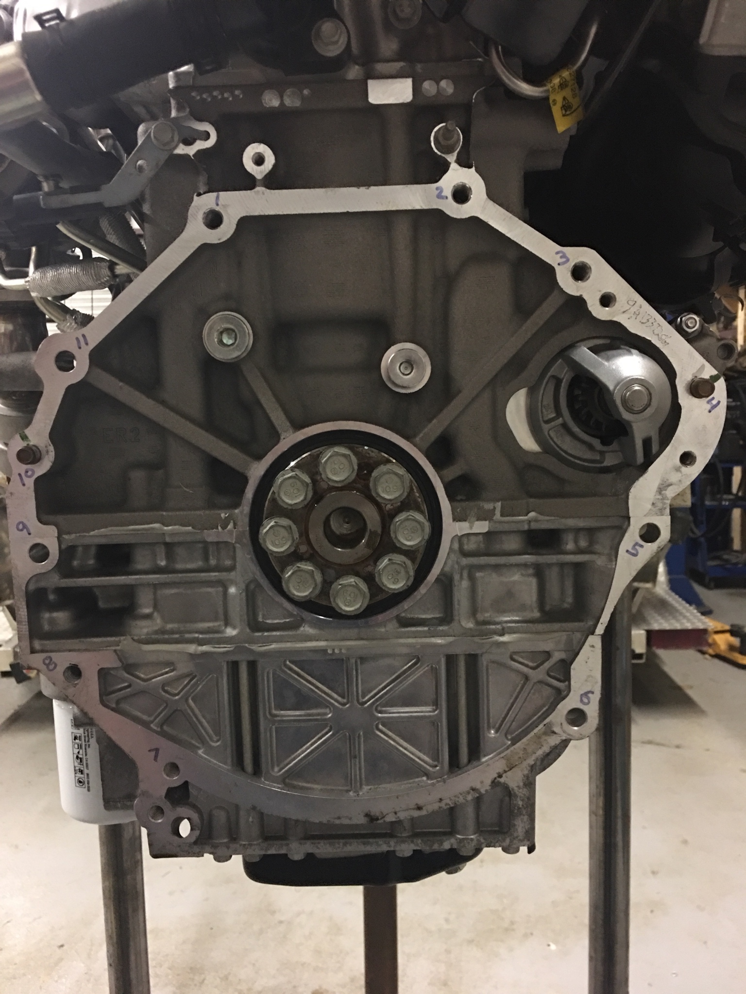

starter is in the wrong location, and the bolt pattern is different. Starter is over the axle in the LTG and its on the opposite side on the "other" ecotec.

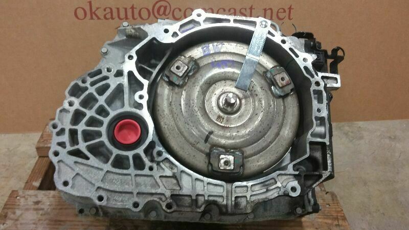

Its 6T70, its a FWD trans but b/c the motor was for Cadillac and the Camaro it started out as a AWD/RWD motor first. At least that's what I've been reading.

I'm nearly certain the bolt pattern is the same on FWD and RWD ecotecs. I've never seen anything to the contrary. They may have put the starter in a different place due to packaging, but that's on the transmission side anyways.

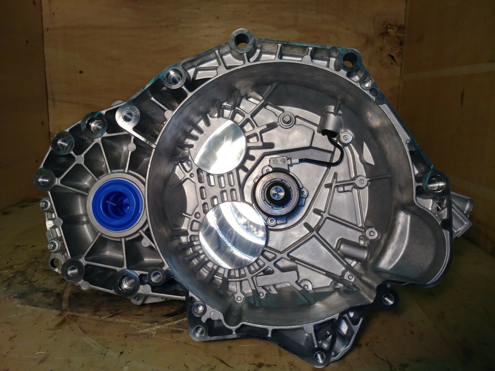

Correct me if I'm wrong, but the starter bolts to the motor right? if so, then the early F40 will not work, b/c there is no "hole" in the 07 F40 case for the starter to "poke out". So even if the 07 trans "could" bolt to the 2016 block, the starter (attached to the block) will interfere with the trans.
Also, I don't think I can just cut the 07 case to fit the 16 starter location. Before I did all that, I'd prob start to see how difficult using the 6spd auto trans will be.
just for ref, here is a pic of the 6T70 auto trans.
and here is a pic of the engine side of the LTG motor.

MAY 19, 04:51 PM
What car did your F40 come out of?
This is from a ZZP F40 swap kit for earlier 2.0 ecotecs
| quote | | Requires Saab 9-3 ('07+ preferred for best performance gearing) or 2011-13 Regal 6 speed F40 transmission and PCM reprogramming to adjust for the new speed sensor. It does fit pre-2007 Saab F40 but the gearing is not optimal. The Regal transmission has poor gearing for drag or road course cars (wide gears, tall final drive), but can be useful for half mile racing. Please don't ask if it will work with XX transmission. It's designed for a Saab or 11-13 Regal trans as stated above and nothing else. |
Both the 2011-2013 and 2014-2016 F40 6 speed option code is MR6, but they don't seem to interchange. The regal didn't get the LTG until 2014, so I guess it's possible they changed the transmission... but... man that seems dumb[This message has been edited by arbakken (edited 05-20-2020).]
