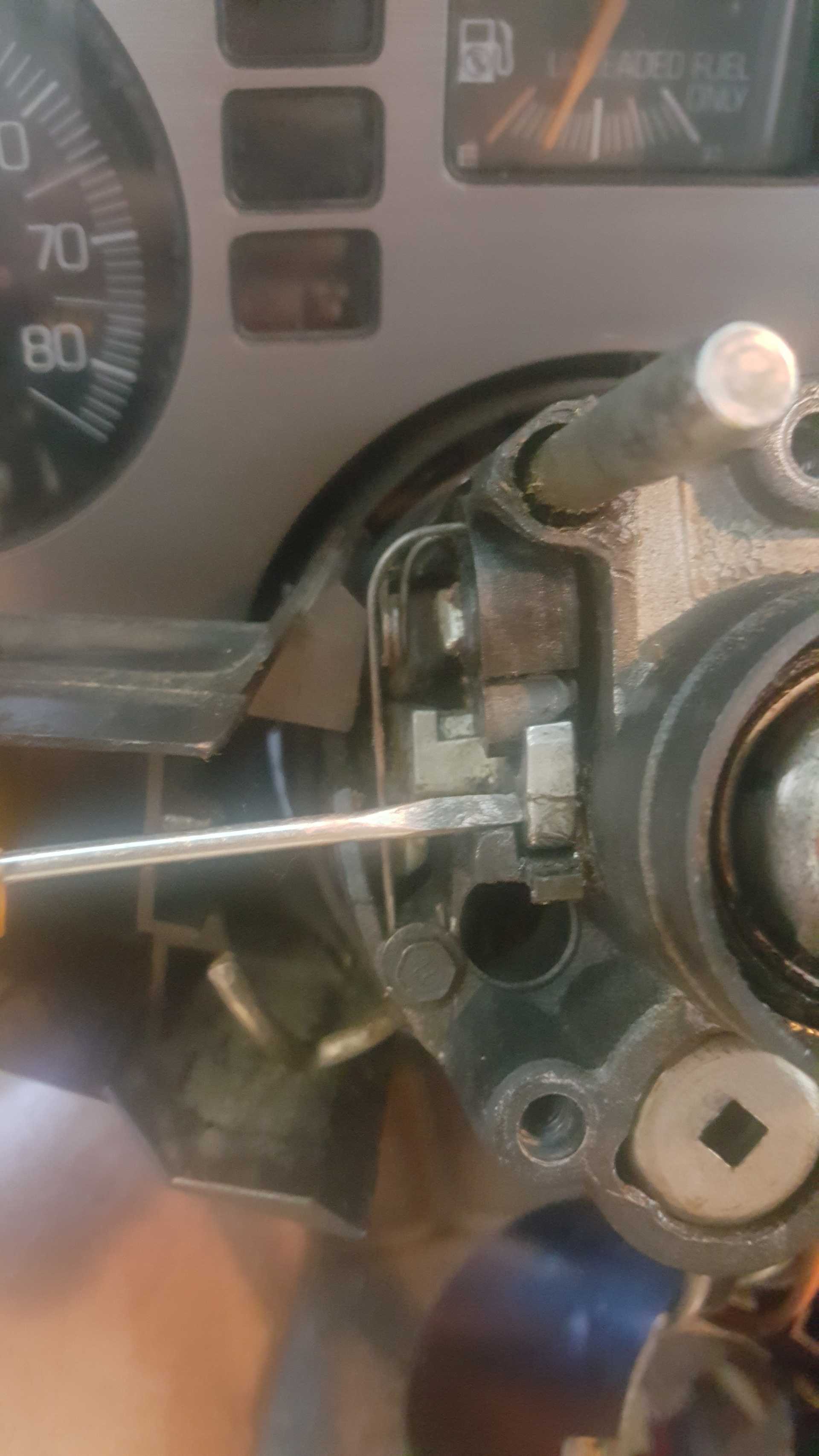

Monkeybean007
MAY 22, 07:07 PM
When I push this in and turn the ignition on it starts no issue so how do I adjust this?
Monkeybean007
MAY 22, 07:11 PM
That's in my steering column 😂

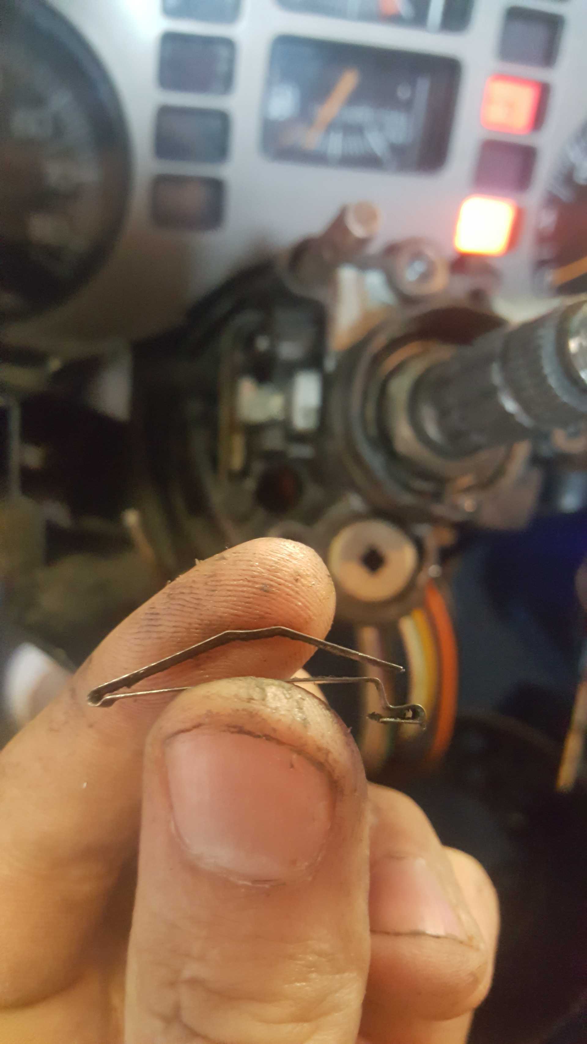

Monkeybean007
MAY 22, 07:31 PM
Also this was just bouncing around in there.
Monkeybean007
MAY 23, 01:28 AM
Just gonna add all the info I figure out in hopes one of you can help piece it together, by using the tilt lever and adjusting the steering column it will also help start the car up fine, so I am thinking that it has to do with the pushrod not being lined up somehow.
MAY 23, 02:55 AM
| quote | Originally posted by Monkeybean007:
...it warms up and then I try to restart it again after turning it off, it won't start, no cranking anything the lights come on inside and so does the radio, usually I have to wait for a bit to get it to start
Do you hear the starter solenoid click when you turn the key?
Yes
...by using the tilt lever and adjusting the steering column it will also help start the car up fine, so I am thinking that it has to do with the pushrod not being lined up somehow.
IMO, something doesn't add up here. If you hear the starter solenoid "click" when you turn the key, then as far as I know, the ignition switch is doing its job in regards to engaging the starter. I readily admit to not being an electrical expert by any means, so any other input here could prove to be useful.[This message has been edited by Patrick (edited 05-23-2020).]
Eliredandblack
MAY 23, 03:17 AM
The spring clip in your photo looks like the typical GM contact for “key left in ignition buzzer.” I ordered a new one for my 73 Vette, but don’t have the nerve to dig that far into the steering column. I will bet your key left in the ignition never caused the chime/buzzer to sound. Test chime by leaving lights on or e brake.
