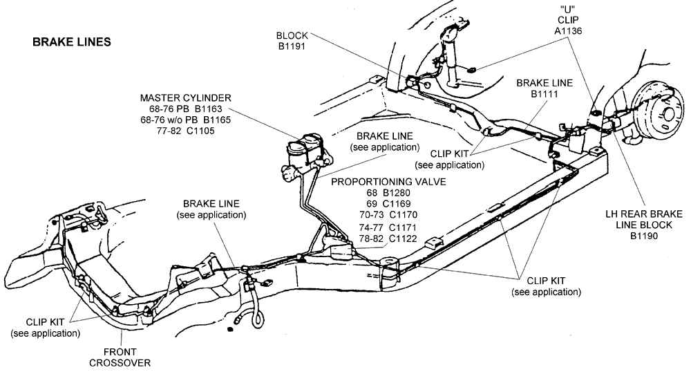

Originally posted by Mike in Sydney:
Bleed the calipers starting from the one furthermost from the master cylinder. This is actually the RR because of the way the brakelines run. Then LR, RF, and LF.
This is getting too weird.
I don't know if your Fiero in Australia has been modified (everything swapped sides) for right-hand drive or what.... but from the factory, the Left Rear brake caliper is the furthest along the brake line from the master cylinder.
[This message has been edited by Patrick (edited 05-09-2020).]

Patrick MAY 09, 04:40 PM
...the recommended bleeding wheel sequence for bleeding is Right Rear, Left Rear, Right Front, and Left Front. My source is page BRAKES 5-7, step 4 in the manual bleed instructions in the '86 Factory Service Manual. I've always used this sequence but I'm interested to know if going LR, RR, RF, LF is better.
Mike, we all seem to agree that bleeding is to be done starting with the furthest caliper from the master... yet there still seems to be this blind allegiance to the service manual when it's obviously wrong!
On a conventional left-hand drive vehicle, the brake master cylinder is towards the Left Front. The rear brake line then tees off somewhere in the back. If the tee is closer to the left side, which isn't unusual as the brake line often runs down the same side (left) as the master, then the furthest caliper is the Right Rear.
If the tee is in the middle, then it really isn't critical at all which rear caliper is bled first.
It was therefore safe to state in 99.99% of all service manuals (for left-hand drive vehicles) that the bleeding sequence should be Right Rear, Left Rear, Right Front, Left Front. The Fiero is an oddball however, as the rear tee is literally only a few inches from the Right Rear caliper. There is no doubt then that the Left Rear caliper on our Fieros is the furthest from the brake master.
Yes, the Fiero factory service manuals are indeed wrong! We've had more than 30 years to recognize this error... and to act accordingly!
